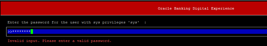

Invalid database password
This topic contains troubleshooting information if you receive an error when attempting to connect to the database server.
If you get the following error:
Try one of the following:
- Verify that the database is running.
- Check Network connectivity between Weblogic Server and Database server.
- Check the database configuration in installer.properties file
- Verify that the entered password is correct.

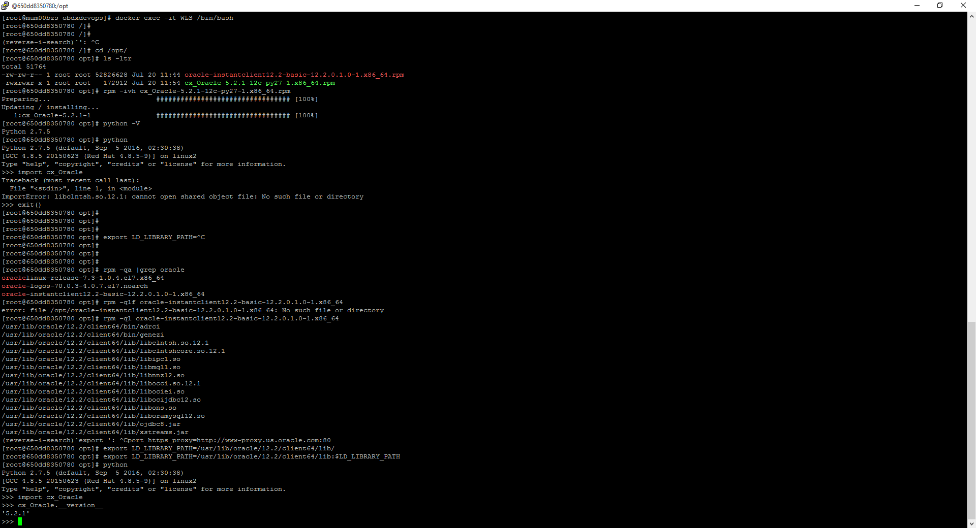

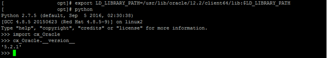

Execute the below command:
export LD_LIBRARY_PATH=/usr/lib/oracle/12.2/client64/lib:$LD_LIBRARY_PATH
python
import cx_Orace
cx_Oracle.__version

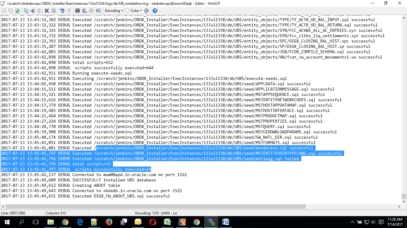

If you get the following error in DB_installation.log:
Check the detailed log of the failed SQL file at <OBDX INSTALLER DIR>/ExecInstances/<DDMonthHHMM>/logs/db folder.

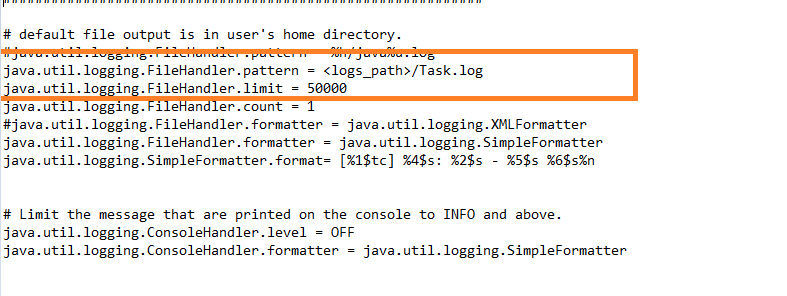

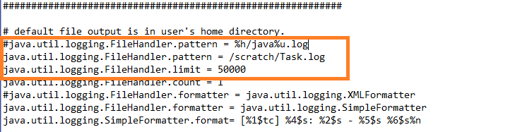

- Edit Entitlement_log4j.properties & Task_log4j.properties & Dashboard_seed_log4j.properties. Replace <logs_path> with directory where policy seeding logs will be generated
For example:
