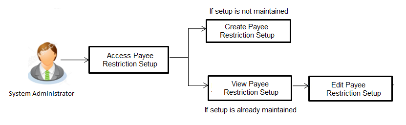

Workflow
How to reach here:
System Administrator Dashboard > Payments > Payee Restrictions
OR
System/ Bank Administrator Dashboard > Toggle Menu > Payments > Payee Restrictions
