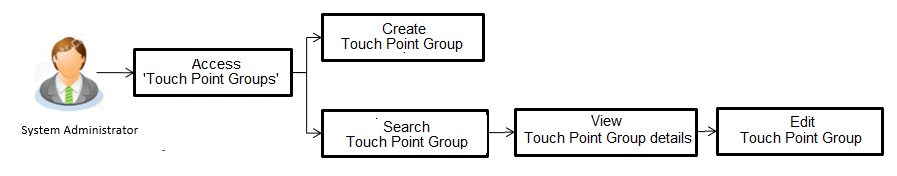

Workflow
Features supported in application
The administrator can perform the following actions:
