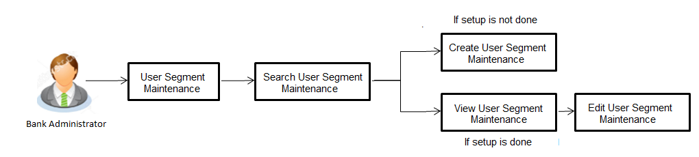

Workflow

User Segment Maintenance - Search
Using this option, System Administrator user can search the user segments maintained for retail users. The search result displays matching results based on search criteria entered.
System Administrator can view details of a specific segment by selecting the segment ID to get required details for a segment.
