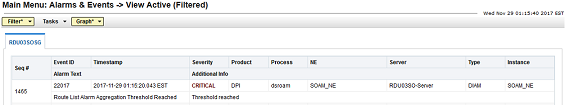

  1. Examine the alarm log from Main Menu > Alarms & Events on Active SOAM Server.
    img/aggregation.png
