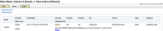

- To get further information regarding this issue:
- Examine the alarm
log from
Main
Menu > Alarms & Events on Active SOAM Server.
- Get the Connection ID IcRate[Connection_Id] from Alarm Details and the corresponding Connection Name from TransportConnectionTable on active SOAM server.
- Investigate the connection's remote Diameter peer (the source of the ingress messaging) to determine why they are sending the abnormally high traffic rate.
