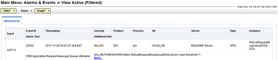

  1. Examine the alarm log from Main Menu > Alarms & Events on the active SOAM server.
    img/appliction_max_utilization.png
