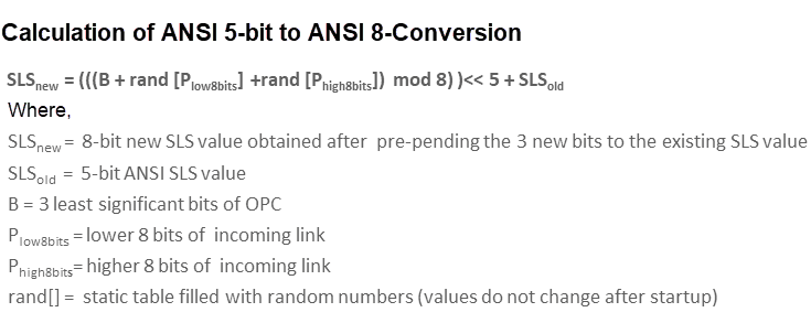

    If the above conditions are fulfilled, then only the new SLS value is calculated as per the following figure:
    Figure 2-31 ANSI 5-bit to ANSI 8-bit SLS Conversion
    img/5-bit_ansi_to_8-bit_ansi_sls_conversion.png
