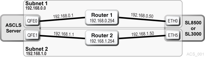

Scenario 1 is the preferred configuration for the dual TCP/IP feature.
In this configuration, the ACSLS server contains two network interfaces that reside on two separate subnets. The SL8500 or SL3000 has two network interfaces on the same two subnets as the ACSLS server.
In this scenario, the libraries use a one-to-one relationship with the network interfaces on the ACSLS server in which the:
qfe0 interface on the ACSLS server only communicates with the eth0 interface on the SL8500 or SL3000.
qfe1 interface on ACSLS only communicates with eth5 on the SL8500 or SL3000.
Using the UNIX ”route
” commands, you force this relationship.
For Solaris: as user root
, type the following commands:
route -p add 7.0.50 -ifp qfe0 192.168.0.254
route -p add 192.168.1.50 -ifp qfe1 192.168.1.254
The first route command routes any communication with 192.168.0.50
to go through qfe0 on the ACSLS server and then go through Router 1.
The second command routes any communication with 192.168.1.50
to go through qfe1 on the ACSLS server and then go through Router 2.
You can validate that the routes are in the routing table by typing:
# netstat –r
Example B-1 IPv4 Routing Table
Destination Gateway Flags Ref Use Interface ______________ ________ _____ ___ ___ _________ 192.168.0.50 192.168.0.254 UGH 1 0 qfe0 192.168.1.50 192.168.1.254 UGH 1 0 qfe1 192.168.0.0 192.168.0.1 U 1 7 qfe0 192.168.1.0 192.168.1.1 U 1 0 qfe1 BASE-ADDRESS.MCAST.NET 192.168.0.1 U 1 0 qfe0 default 192.168.0.254 UG 1 33 localhost localhost UH 4 77 lo0
The first two entries are the ones that were just added. All communication with 192.168.0.50
will go through QFE0, and communication with 192.168.1.50
will go through QFE1.
Remember: Configure the libraries' routing tables according to the instructions in the StorageTek SL8500 Modular Library System Dual TCP/IP Feature document.

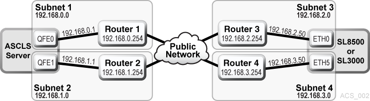

Scenario 2 shows:
ACSLS server with two interfaces on separate subnets from the library
SL8500 or SL3000 library with two network interfaces on separate subnets from ACSLS
Both ACSLS and SL8500 or SL3000 using a public network
Figure B-2 ACSLS and SL8500 or SL3000 Using a Public Network
Using the UNIX ”route” commands, you force this relationship.
#route add 192.168.2.50 -ifp qfe0 192.168.0.254
#route add 192.168.3.50 -ifp qfe1 192.168.1.254
The default routes for the ACSLS remain the same. The routes within the subnets will know how to route communication to the libraries through the public LAN and you are still forcing the one to one relationship with the interfaces. Again, this is seen using the following command:
# netstat –r
Remember: Configure the libraries' routing tables according to the instructions in the StorageTek SL8500 or SL3000 Modular Library System Dual TCP/IP Feature document.

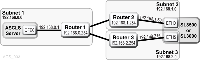

In this scenario, there is one ACSLS server with one network interface on a separate subnet. The SL8500or SL3000 library has two network interfaces on two subnets that are separate from the ACSLS server.
Figure B-3 SL8500 or SL3000 with Two Network Interfaces
Remember: Configure the library routing tables according to the instructions in the StorageTek SL8500 or SL3000 Modular Library System Dual TCP/ IP Feature document.

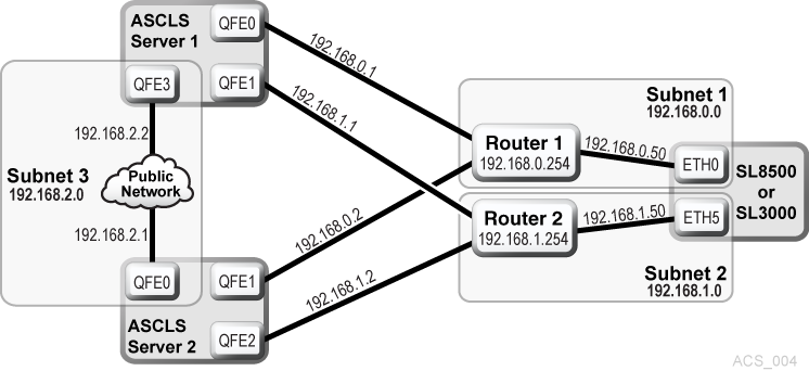

Two Highly Available (ACSLS HA) servers, both with three network interfaces, two separate private subnets with the SL8500 or SL3000, and a third public network.
One SL8500 or SL3000 library with two network interfaces on the same two private subnets as the ACSLS servers.
In this scenario, ACSLS HA uses two different servers with each using different network interfaces. This means that custom route entries must be added to both ACSLS servers.
For the Solaris user:
On ACSLS server 1, you would type:
route add 192.168.0.50 –ifp qfe0 192.168.0.254
route add 192.168.1.50 –ifp qfe1 192.168.1.254
On ACSLS Server 2, you would type:
route add 192.168.0.50 –ifp qfe1 192.168.0.254
route add 192.168.1.50 –ifp qfe2 192.168.1.254
You must add the IP addresses for both servers to the libraries' configuration. Refer to the StorageTek SL8500 or SL3000 Modular Library System Dual TCP/IP Feature document.
It is important that you separate the libraries' network interfaces over two different subnets when on ACSLS HA. The purpose of a Highly Available environment is to build in redundancy and eliminate single points of failure.
Remember: Configure the libraries' routing tables according to the instructions in the StorageTek SL8500 or SL3000 Modular Library System Dual TCP/ IP Feature document

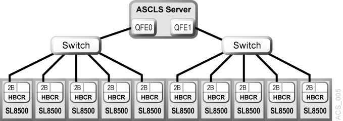

When SL8500 3.97 or higher firmware is installed, ACSLS can connect to more than one SL8500 in an ACS (library complex).
ACSLS supports up to fifteen connections to an ACS. For example, this can be: fifteen connections to four SL8500s; two connections to each of two SL8500s; two connections to one SL8500 and two connections to two other SL8500s; three connections to two or three libraries, and so on.
When ACSLS is connected to more than one library, the connections should be through different subnets for redundancy. If one subnet fails, communication between ACSLS and the library still continues over the other subnet(s).
When ACSLS has two connections to one SL8500 HBC card, you should configure the SL8500 and ACSLS server routing tables as described in "Dual TCP/IP Support". If you have only a single connection between the ACSLS server and each SL8500 HBC card, configuring the ACSLS and SL8500 routing tables is not necessary.
To optimize library performance, and minimize inter-library communication among SL8500s, define your first connection (port 0) to the library with the most activity.
Configuring and managing Multi TCP/IP communication is simpler than Dual TCP/IP because routing tables do not need to be defined on the ACSLS server or the SL8500 libraries. However, Multi TCP/IP requires a string of connected SL8500 libraries. It does not apply to single, stand-alone, SL8500 or SL3000 libraries.
For more information, refer to the StorageTek SL8500 Modular Library System Technical Brief - Host to Library Communications.
Figure B-5 shows an ACSLS with Multi TCP/IP configuration and Figure B-6 shows an ACSLS with Multi TCP/IP and Dual TCP/IP configuration.

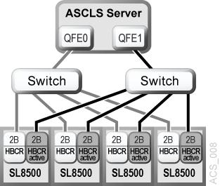

Figure B-7 shows ACSLS with RE in a single library.
ACSLS handles a mix of active and standby SL8500 Library Controller (LC) cards within a single library complex (an ACS of libraries connected by pass-thru).
As shown in Figure B-8, either of the HBCR cards in each SL8500 can be the active controller card.
Figure B-8 ACSLS with RE and Multi TCP/IP
