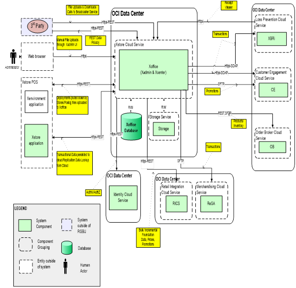

Figure 3-1 below shows the integration data flows and the corresponding webservices APIs that are available in Xstore Office Cloud Service.
Figure 3-1 Xstore Office Cloud Service Integration Data Flow
As you can see from the diagram in Figure 3-1 Xstore Office Cloud Service does not have its own SFTP server.
Xstore Office Cloud Service does not use a WebDAV server for file deployments and pospoll uploads.
To get data from/upload data to XOCS the retailer will need to use the REST APIs documented in the Oracle Retail Xstore Suite Services Guide (My Oracle Support Doc ID: 1994467.1). The guide has details on invoking the File Rest API to PUT/GET/DELETE and view listing of the files in containers.
Another thing worth mentioning is that XOCS environments are provisioned with empty Xcenter and Replication databases and minimum required data in Xadmin database.
It will be responsibility of the retail/SI partner teams to load data in XOCS. Refer to Data Seeding on how to load data in XOCS.
