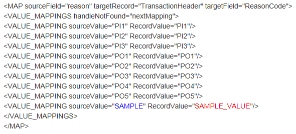

RTLogMappingConfig.xml:
The RTLog Generator application relies heavily on the XML-based mapping which provides extensibility and a way to maintain/upgrade features for the application. This file can be used to override all the field values for either mapping strategy:
FieldMapperThenValueMapping: The RecordValue attribute values as shown in the following example can be changed:
<MAP sourceField="tenderId" targetRecord="TransactionHeaderTotal" targetField="ReferenceNumber1" mappingStrategyOrder="FieldMapperThenValueMapping" fieldMapper="trnHeaderTotalMapper"> <VALUE_MAPPINGS handleNotFound="success"> <VALUE_MAPPING sourceValue="GIFT_CERTIFICATE" RecordValue="GIFTCERT" /> <VALUE_MAPPING sourceValue="HOUSE_ACCOUNT" RecordValue="HACCNT" /> <VALUE_MAPPING sourceValue="ISSUE_STORE_CREDIT" RecordValue="ISTCRDT" /> <VALUE_MAPPING sourceValue="ISSUE_MERCHANDISE_CREDIT_CARD" RecordValue="IMCCARD" /> <VALUE_MAPPING sourceValue="ISSUE_XPAY_GIFT_CARD" RecordValue="IXPAYGC" /> <!--For e.g above given value can be changed as shown here.--> <VALUE_MAPPING sourceValue="ISSUE_XPAY_GIFT_CARD" RecordValue="SAMPLE_IXPAYGC" /> <VALUE_MAPPING sourceValue="MALL_CERTIFICATE" RecordValue="MALLCERT" /> <VALUE_MAPPING sourceValue="MERCHANDISE_CREDIT_CARD" RecordValue="MCCARD" /> <VALUE_MAPPING sourceValue="PAYPAL" RecordValue="PAYPAL" /> <VALUE_MAPPING sourceValue="COUPON" RecordValue="QPON" /> <VALUE_MAPPING sourceValue="ROOM_CHARGE" RecordValue="ROOMCHAG" /> <VALUE_MAPPING sourceValue="RELOAD_XPAY_GIFT_CARD" RecordValue="RXPAYGC" /> <VALUE_MAPPING sourceValue="RELOAD_MERCHANDISE_CREDIT_CARD" RecordValue="RMCCARD" /> <VALUE_MAPPING sourceValue="STORE_CREDIT" RecordValue="STCRDT" /> <VALUE_MAPPING sourceValue="XPAY_GIFT_CARD" RecordValue="XPAYGC" /> </VALUE_MAPPINGS> </MAP>
No mappingStrategyOrder and fieldMapper attributes are defined: The RecordValue attribute values shown in the following example can be changed or a new value can be added:
<MAP sourceField="reason" targetRecord="TransactionHeader" targetField="ReasonCode"> <VALUE_MAPPINGS handleNotFound="nextMapping"> <VALUE_MAPPING sourceValue="PI1" RecordValue="PI1"/> <VALUE_MAPPING sourceValue="PI2" RecordValue="PI2"/> <VALUE_MAPPING sourceValue="PI3" RecordValue="PI3"/> <VALUE_MAPPING sourceValue="PO1" RecordValue="PO1"/> <VALUE_MAPPING sourceValue="PO2" RecordValue="PO2"/> <VALUE_MAPPING sourceValue="PO3" RecordValue="PO3"/> <VALUE_MAPPING sourceValue="PO4" RecordValue="PO4"/> <VALUE_MAPPING sourceValue="PO5" RecordValue="PO5"/> <VALUE_MAPPING sourceValue="SAMPLE" RecordValue="SAMPLE_VALUE"/> </VALUE_MAPPINGS> </MAP>

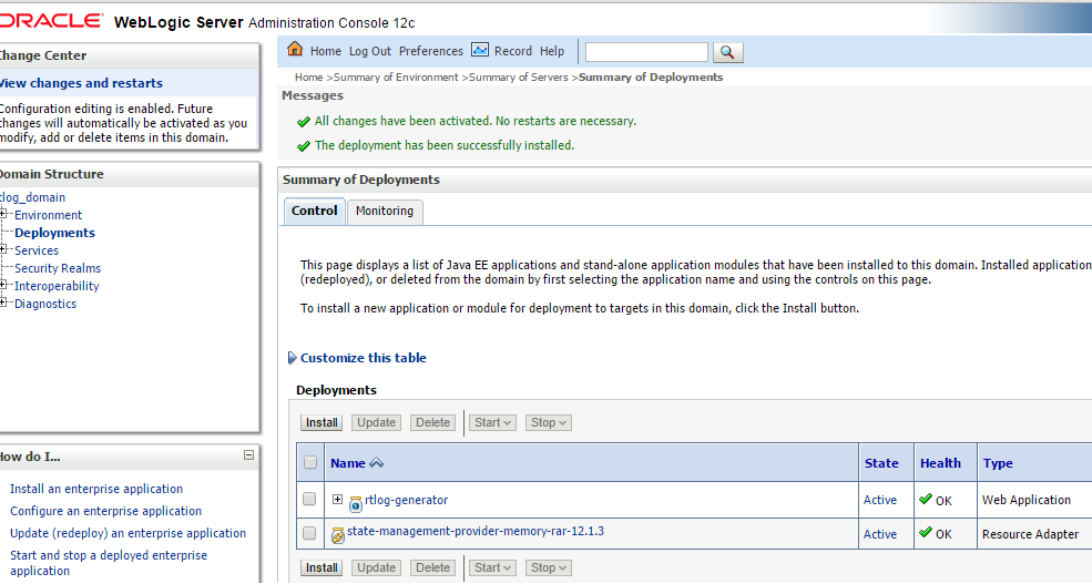

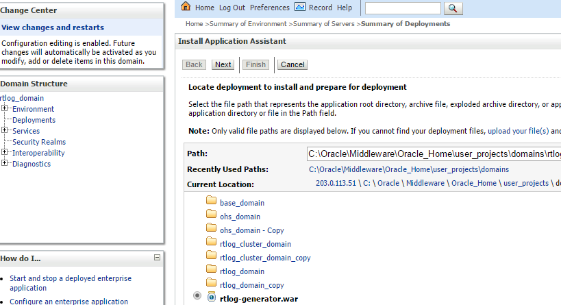

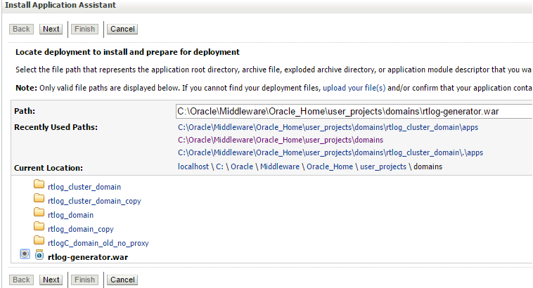

To deploy the RTLog Generator application:
Log in to the WebLogic 12 Server Administration Console (http://<hostName>:<port>/console).
Click the Deployment link from the left navigation menu.
Click Install.
Navigate to the rtlog-generator.war file directory. Select the rtlog-generator.war option.
Click Next and then Finish. Once deployed, RTLog Generator should be listed as one of the deployed applications as shown in Figure 6-9.

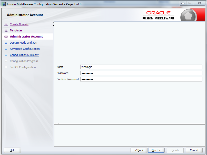

On the Administrator Account page, enter the Administrator user name and password. Enter the password a second time to confirm. Click Next.

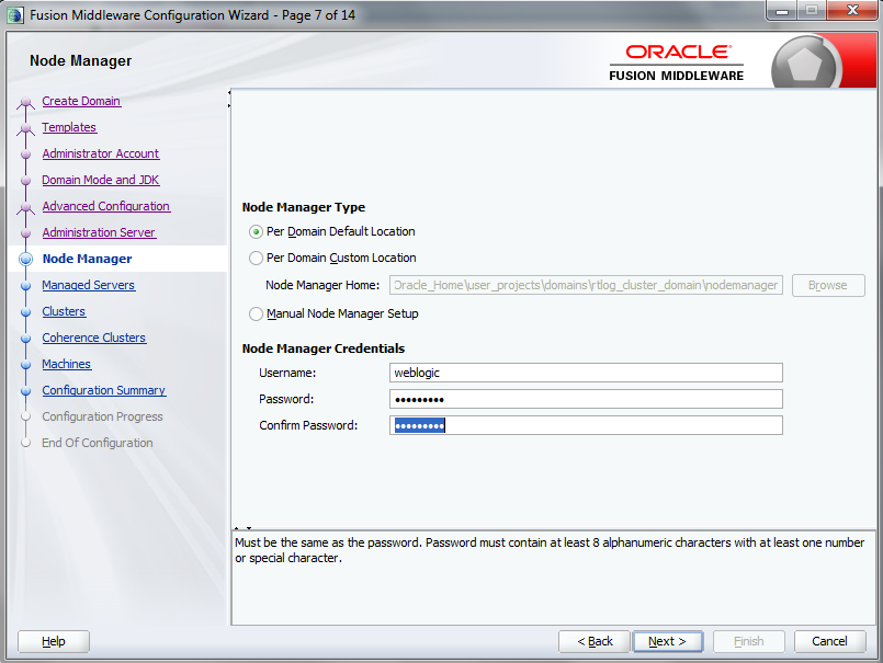

On the Node Manager page, do not change the default node manager settings. For the credentials, enter weblogic as the user name and enter the password. Click Next.

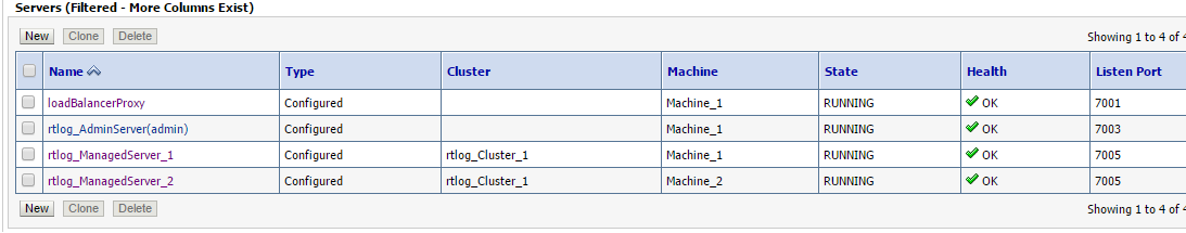

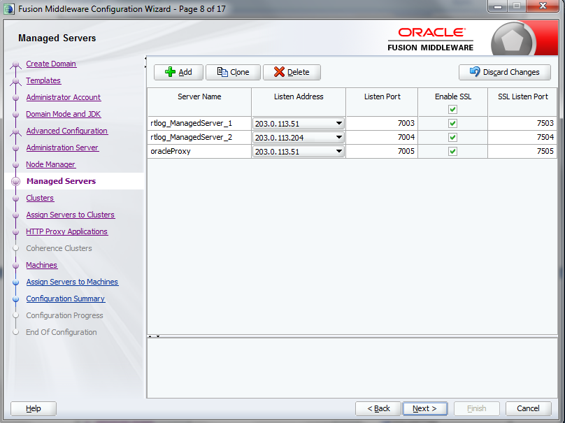

On the Managed Servers page, add and configure each managed server:
For the listen address, enter the IP address of the managed server. Do not select All local Addresses.
rtlog_ManagedServer_1 will be running on Machine_1 in this configuration. Enter the Machine_1 IP address for the server.
rtlog_ManagedServer_2 will be running on Machine_2 in this configuration. Enter the Machine_2 IP address for this server.
oracleProxy is running on Machine_1, but is not a part of the cluster. It is an Oracle proxy HTTP cluster servlet used for failover and load balancing purposes. Enter the Machine_1 IP address for this server.
Enable SSL for all the managed servers.
Click Next.

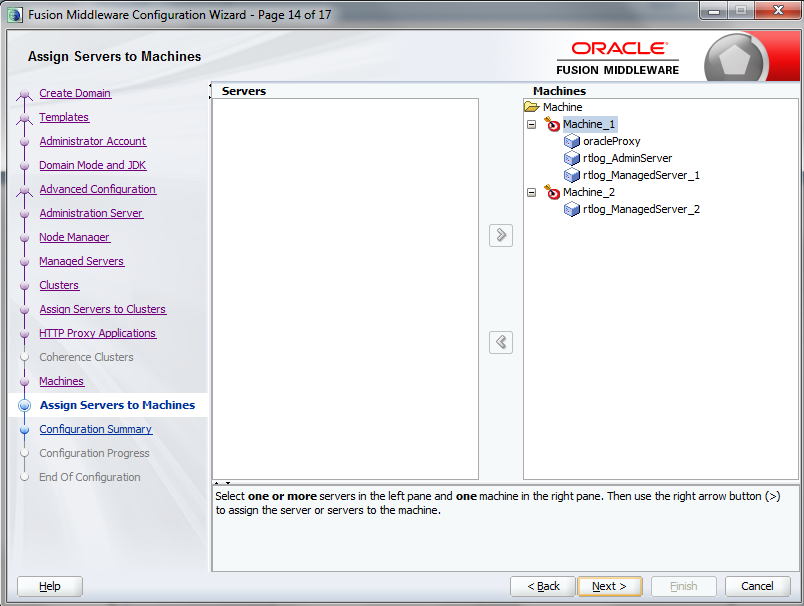

On the Assign Servers to Machines page, assign the servers to the machines. In this example, Oracle proxy (load balancer), Administration server, and one managed server are configured on Machine_1. Another managed server is configured on Machine_2. Click Next.

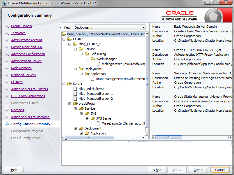

On the Configuration Summary page, verify the selected configuration. Click Create. The domain is created.

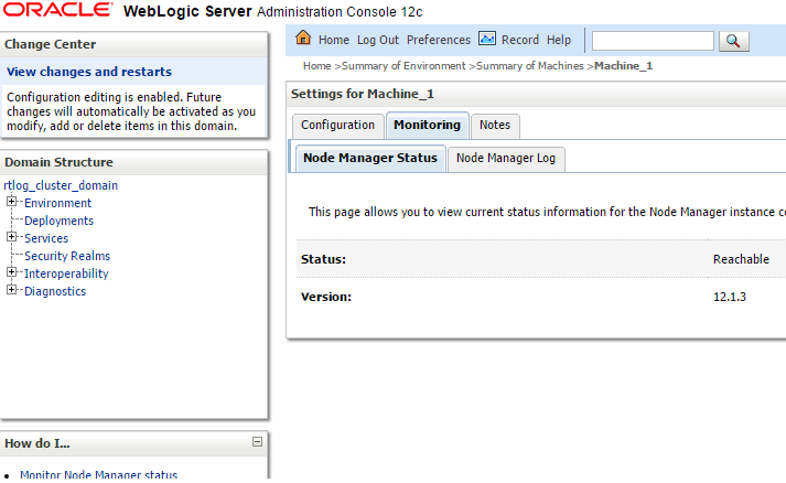

Log in to the Administration Server console and make sure all the node managers are reachable. This can be found under Machines. Repeat this step for all the clustered machines to ensure all of them are reachable.

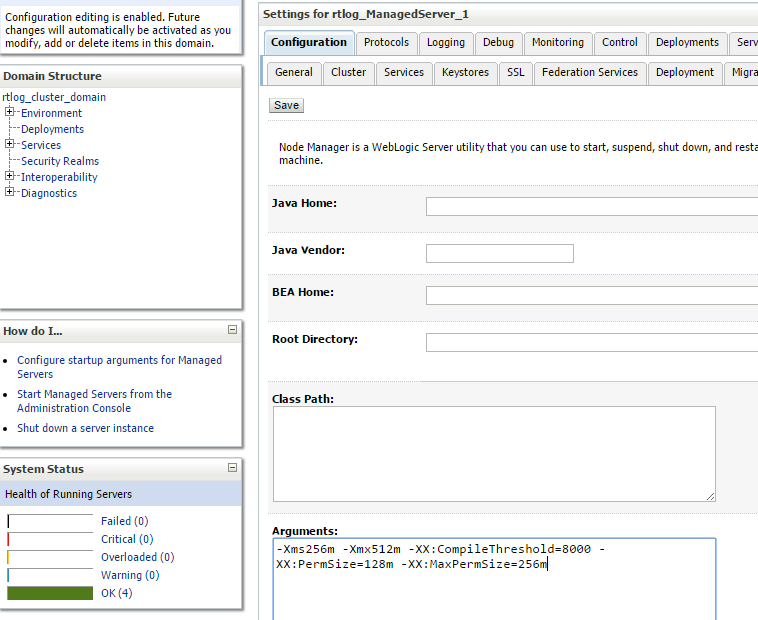

For each managed server, select the Server Start tab. In the Arguments text box, add the following if it does not already exist:
-Xms512m -Xmx512m -XX:CompileThreshold=8000 -XX:PermSize=512m -XX:MaxPermSize=512m
If you want to configure the non-default external RTLog configuration directory, include an additional JVM argument:
-Drtloggen.config.dir=C:/<rtlog-gen-config_1>/

Start all the managed servers including the Oracle proxy. Figure 6-26 shows an example of the list of managed servers.

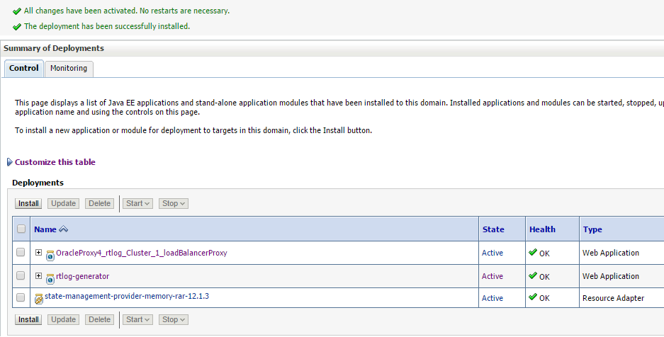

Navigate to the Administration Console home page and click Deployments in the left navigation menu. Figure 6-27 shows an example of the page before deploying the RTLog Generator application.
Click Install. The Install Application Assistant page appears. Select the path to the RTLog Generator WAR directory. Select the rtlog-generator.war option. Click Next.
Select only the managed servers and click Next to finish the deployment.
After it is successfully deployed, the RTLog Generator application appears in the Summary of Deployments page.

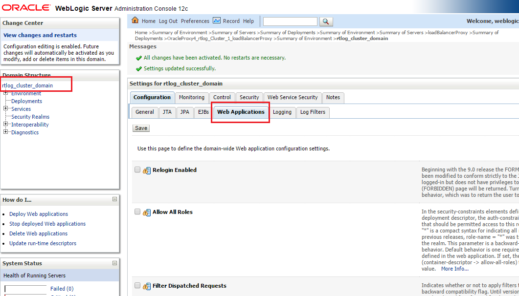

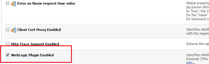

To enable the WebLogic Plugin Enabled parameter from the cluster domain:
Click the <rtlog_cluster_domain> link in the left navigation menu. Navigate to the Web Application tab.
Scroll down the page and select WebLogic Plugin Enabled. Click Save.

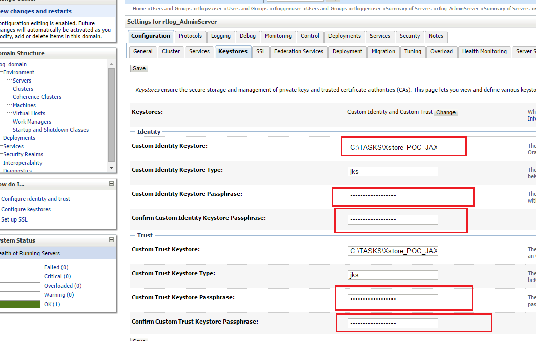

The RTLog Generator application is secured by leveraging two levels of security:
Container level security: Basic HTTP authentication by setting up the security realm in WebLogic. To configure this security, see "Container Level Security".
Transport level security: SOAP requests are sent over the secured protocol (HTTPS) by configuring the keystore/truststore in the WebLogic domain and importing the public certificate into Xstore Office's (client) truststore. To configure this security, see "Transport Level Security".

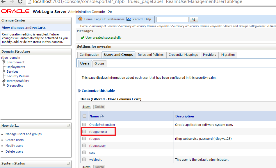

The following steps assume that a domain has been created with secure port (HTTPS) enabled. To configure container level security:

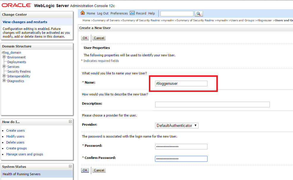

Start the WebLogic server and log in to Administration Console.
Click Security Realms in the left navigation menu.
In the list of realms on the Summary of Security Realms page, select myrealm.
Select Users and Groups and then the Groups tab. To create a new group, click New. Enter a group name, for example RTLogUserGroup, and click OK.
Select the Users tab and click New. Enter a user name and password and click OK.
In the list of users, click the newly created user.
Select the Groups tab. Assign this user to the same group created in Step 4.
Enter the same user name and password created in Step 5 into Xstore Office's broadcaster configuration for the RTLog Generator Web service.

Log in to the WebLogic console. Click Environment and then the Servers link from the left navigations menu.
Click Change. Select Custom Identity and Custom Trust. Click Save.
Click the linked name for the Administration Server. The page containing the settings for the Administration Server appears. Select the Keystores tab.
Enter the path to keystore.jks, including the file name, and enter the custom Identity Keystore passphrase you created for the keystore. Repeat this for trustore.jks, but enter the appropriate passphrase for the truststore. For an example, see Figure 6-41.
Switch to the SSL tab. Enter the alias name and private keyphrase as created during the certificate generation. To save the changes, click Save.
Note: For a clustered environment, disable the non-SSL port for the HttpClusterServlet proxy. |
