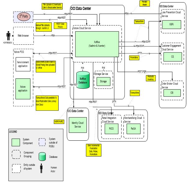

Figure 3-1 below shows the integration data flows and the corresponding webservices APIs that are available in Xstore Office Cloud Service.
Figure 3-1 Xstore Office Cloud Service Integration Data Flow
As you can see from the diagram in Figure 3-1 Xstore Office Cloud Service does not have its own SFTP server.
Xstore Office Cloud Service does not use a WebDAV server for file deployments and pospoll uploads.
To get data from/upload data to XOCS the retailer will need to use the REST APIs documented in the Oracle Retail Xstore Suite Services Guide (My Oracle Support Doc ID: 1994467.1). The guide has details on invoking the File Rest API to PUT/GET/DELETE and view listing of the files in containers.
