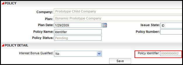

Scenario 1
A configuror creates a field on the Policy screen that will generate an ID. When the policy is created and saved for the first time, the identifier number will automatically populate the field on the Policy screen.

View New Feature in OIPA
View this configuration in OIPA by logging into the Company | Plan you identified in the steps above. Create a new policy. Add policy details and click the Save button. The identifier field should be disabled and should show the unique ID generated by the system.
Identifier field on Policy screen
Identifier Field on Policy Screen
