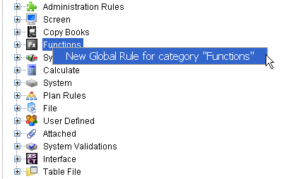

  1. Go to Global Rules Explorer tab.
  2. Right-click on the Functions folder.
Function Right-Click
Function Right-Click Option
  1. Select New Global Rule for Category Functions.
