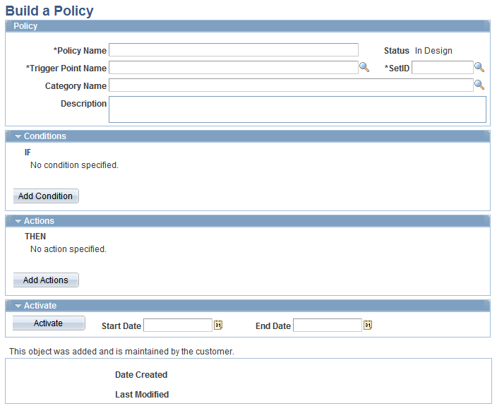

To create a new policy, click the Build a Policy button to access the Build a Policy (EOCF_RULE_DEFN) page.
Image: Build a Policy page
This example illustrates the fields and controls on the Build a Policy page. You can find definitions for the fields and controls later on this page.
Build a Policy page
Field or Control
Definition
Policy Name
Enter a unique and descriptive name for the policy.
Trigger Point Name
Select a trigger point from the drop-down list box.
A policy is always associated with at least one trigger point.
Category Name
Select a policy category name from the drop-down list box.
This name is used to functionally classify policies and aid in searching for policies.
SetID
Select from a list of set IDs that are defined within the PeopleSoft system.
Specify a setID and a trigger point for every policy. This value is used to select the valid set of policies associated with a trigger point at runtime. This value also constrains the prompt list for the right-hand side values entered in conditions by performing a setID to setID indirection.
Status
The default value for a new policy is In Design.
When you click the Activate button and activate the policy, the status changes to Active.
Start Date and End Date
Enter the start and end dates. These dates define the validity of a policy at runtime.
Complete the appropriate fields and click Add Conditions.

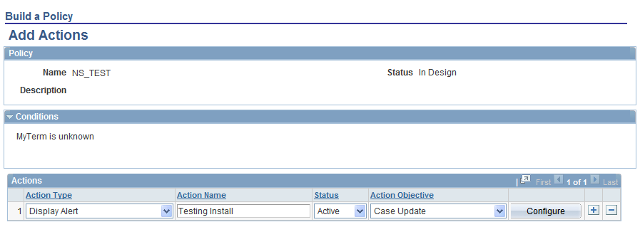

Adding, Editing, and Configuring Actions
Click Add Actions or Edit Actions on the Build a Policy page to access the Add or Edit Actions page.
Image: Add Actions page
This example illustrates the fields and controls on the Add Actions page. You can find definitions for the fields and controls later on this page.
Add Actions page
If the action type is configurable, the Configure button is enabled on the page. Individual action types have specific configuration pages.

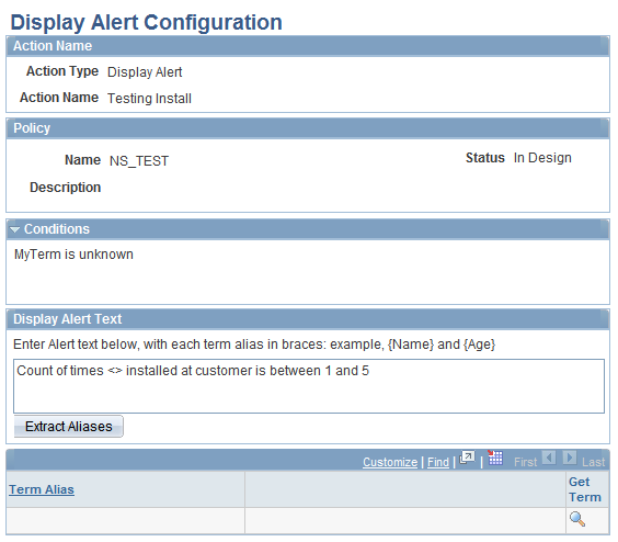

Configuring the Display Alert Action
Access the Display Alert page by selecting Display Alert action type.
Image: Display Alert Configuration page
This example illustrates the fields and controls on the Display Alert Configuration page. You can find definitions for the fields and controls later on this page.
  1. Click Configure.
    The Display Alert Configuration page appears.
  2. Enter text in the Display Alert Text field and include any term aliases in braces.
    Term aliases are placeholders for dynamic content to be merged in the alert text at runtime.
  3. Click Extract Aliases to extract term aliases to populate the grid, thus enabling you to map each alias to a term.
  4. Click Get Term to map a term for each term alias in the grid.
    Only terms that return a single value can be used within the display text. Return data types of record or rowset, or terms with Many rows specified are not allowed.
  5. Click OK or Apply to save the display alert configuration.
    This configuration is retrieved at runtime to generate the alert text and display it in a popup box.

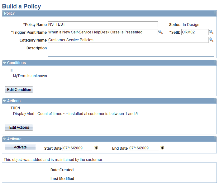

Activating a Policy
Access the Build a Policy page (Enterprise Components, Active Analytics Framework, Policies, Manage Policies).
Build a Policy page
On the Build a Policy page, click the Activate button.
The system sets the status to active after executing validations. Activating a policy disables field editing; however, the policy can still be copied and associated with another trigger point.
Note: Upon activation of the policy, any modifications made are in effect only in new user sessions. Therefore, you must sign out and sign in again to see any changes made to the policy.

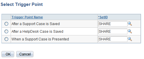

Associating a Policy to Another Trigger Point
A policy can be associated with more than one trigger point within the same setID. Do this by:
  1. Adding a new row to the Associated Trigger Points grid.
  2. Selecting a valid trigger point from the drop-down list box:
    Image: Select Trigger Point page
    This example illustrates the fields and controls on the Select Trigger Point page. You can find definitions for the fields and controls later on this page.
    Note: The trigger points available for selection in the drop-down list box are constrained by the terms used in the policy condition and the actions configured in the policy. Also, a policy cannot be associated with multiple trigger points spanning multiple setIDs.
  3. Saving the policy to associate the policy with the new trigger point.

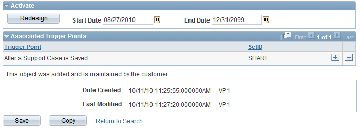

Copying a Policy
Create a new policy by copying an existing one, provided that you can use the same condition and actions. While copying a policy (by clicking the Copy button at the bottom of the Build a Policy page), you'll be prompted for a trigger point and setID. Selecting from the list of valid trigger points results in creating a new policy, which appears on the screen.
Image: Build a Policy page showing Copy button clicked to copy that policy (1 of 2)
This example illustrates the fields and controls on the Build a Policy page showing Copy button clicked to copy that policy (1 of 2). You can find definitions for the fields and controls later on this page.
Image: Build a Policy page showing Copy button clicked to copy that policy (2 of 2)
This example illustrates the fields and controls on the Build a Policy page showing Copy button clicked to copy that policy (2 of 2). You can find definitions for the fields and controls later on this page.
Note: When you copy a policy, the condition and actions, but not the action configurations, are copied to the new policy. Therefore, you need to reconfigure the actions by clicking Edit Actions. A reminder message appears when you're transferred to the new policy.
