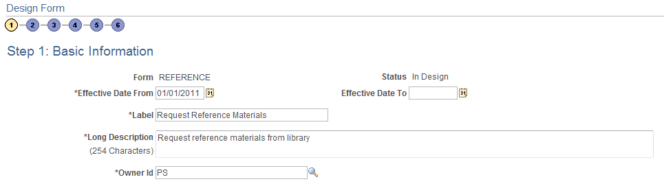

Use the Design Form - Step 1: Basic Information page (FORM_DSN_WZR_MAIN) to define a form's basic information.
Image: Design Form - Step 1: Basic Information page
This example illustrates the fields and controls on the Design Form - Step 1: Basic Information page. You can find definitions for the fields and controls later on this page.
Field or Control
Definition
Form
The unique identifier for the form. You specify this ID when you add a new form.
Status
Lists the current status of the form. The value for this field is automatically assigned. Values are:
  • In Design: Indicates the form is being designed and has not yet been published.
  • Activated: Indicates the form's design is complete, and the form has been published.
  • Inactive: Indicates a form that has been inactivated by either the form's owner or a form administrator.
    Form administrators or form owners can inactivate forms by using the Manage Forms page. When a form is inactive, form users are not permitted to complete the form.
Effective Date From
Enter the date the form is first available for use.
Effective Date To
Enter the date the form expires. Leave this field blank if you intend to use the form indefinitely.
Label
Enter a label for the menu item that users will select to access the form.
Names can contain only alphanumeric and underscore characters.
Long Description
Enter a description for the form. The description appears below the form's label when users access the published form.
Owner Id
Enter the User ID of the person who is the responsible for the form. Only this person can modify the form design.

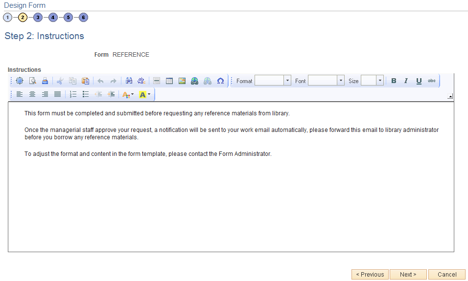

Use the Design Form - Step 2: Instructions page (FORM_DSN_WZR_INST) to provide instructions for users that describe how to complete and submit a form.
Image: Design Form - Step 2: Instructions page
This example illustrates the fields and controls on the Design Form - Step 2: Instructions page. You can find definitions for the fields and controls later on this page.
Enter instructions for completing the form using the HTML editor. Use the toolbar buttons to copy and paste, format text, and insert graphics or links.

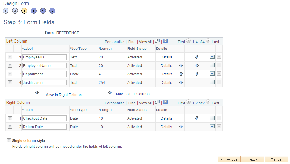

Use the Design Form - Step 3: Form Fields page (FORM_DSN_WZR_FLDS) to define the fields that appear on the form.
Image: Design Form - Step 3: Form Fields page
This example illustrates the fields and controls on the Design Form - Step 3: Form Fields page. You can find definitions for the fields and controls later on this page.
Insert rows within the Left Column and Right Column grids to define the fields that appear on the left and right columns of the form.
For each row, specify values for the following parameters to define the requirements for that field.
Field or Control
Definition
Label
Enter the label to use for this field.
Use Type
Select the field type, and field length, if required (depends on the Use Type). Values are:
Code: Use to define a code field that allows the form user to select a response from a list of codes.
Date: Use for dates.
Number: Use for numeric entries (only positive values are allowed).
Prompt: Defines a prompt field that allows the user to select data from existing PeopleSoft database tables.
Section: Use to separate a form into sections. The section can include a header with instructive text, and an HTML editor is provided for you to define the section.
Signed: Use for signed numeric entries (values can be positive or negative).
Text: Use for text entries.
Time: Use for time entries.
Y/N: Use for yes/no responses.
Length
Select the field length. You can modify this field only for Number, Prompt, Signed, and Text fields; the remaining field types use a preset length.
The syntax for numeric fields is X.Y, where the value before the decimal (X) is the number of integer digits allowed, the value after the decimal (Y) is the number of decimal places allowed.
Field Status
Indicates the status of the field, either Activated or In Design.
Details
Click to access the Form Fields Details page, where you define additional requirements for the field, including whether the field is required, and edits for the field when a user completes the form.
See Form Field Edits Page.
Move Up and Move Down
Click the arrow icons to reposition a field.
Move to Right Column
Click to move selected fields to the right column.
Move to Left Column
Click to move selected fields to the left column.
Single column style
Select to create a form that contains a single column. Any fields that are defined in the right column will appear under the left column fields when you view the form.

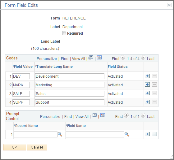

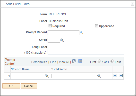

Use the Form Field Edits page (FORM_L_FLD_SEC) to define additional requirements for fields.
Image: Form Field Edits page displaying an example for a prompt field
This example illustrates the fields and controls on the Form Field Edits page example for a prompt field. You can find definitions for the fields and controls later on this page.
Image: Form Field Edits page displaying an example for a code field
This example illustrates the fields and controls on the Form Field Edits page example for a code field. You can find definitions for the fields and controls later on this page.
The fields that appear on this page differ depending on the field's Use Type. The examples provided show how the page appears for a Prompt field and a Code field. The following information lists all of the possible fields that can appear on this page.
Field or Control
Definition
Required
Select to require that a user enter a value in this field in order to save the form.
Uppercase (available only when the Use Type is set to Prompt or Text).
Select to have the system convert the field value to uppercase when the form is saved. Available for only Prompt and Text fields. Use this option for code values, such as department ID, for which it does not matter whether the user enters the value in uppercase or lowercase.
Long Label
Enter up to 100 characters as an alternate label for this field. If you enter a long label, then it will be appear on the form instead of the short label (the value specified in the Label field on the Design Form - Step 3: Form Fields page).
Prompt Record and SetID (available only when the Use Type is set to Prompt)
Select the record that contains the values to use for this field. For SetID based tables, specify the SetID from which to retrieve the values. To complete this field type, a form user can select one of the values from the prompt list, or they can enter a value by typing it into the field.
The records that are available for selection are established by form administrators using the Define Prompt Records page.
See Defining Prompt Records.
Prompt Control (available for all Use Types except Section)
To use the value that a form user enters for this field as the key by which to filter the list of available values in one or more prompt fields elsewhere on this form, insert rows in the Prompt Control grid, and select the Record Name and Field Name for each of the form fields that will reference this field.
For example, to limit the Project IDs available in a prompt field to only those that are associated with the business unit that the user has already selected while completing the form, when designing the form you would:
  • Add a row to the Business Unit field’s Prompt Control grid and specify the record name that equates to the project record, and the field name in that record that equates to business unit.
  • Define the Project ID field as a Prompt field, and specify the same record name that was used for the business unit Prompt Control record name as the prompt record for Project ID. Note: leave the Prompt Control grid empty.
Field Value and Translate Long Name (appear only when the Use Type is set to Code)
Use to define the codes and their associated translate values that are valid for this field. The translate values appear in the drop-down list when the user completes the field.

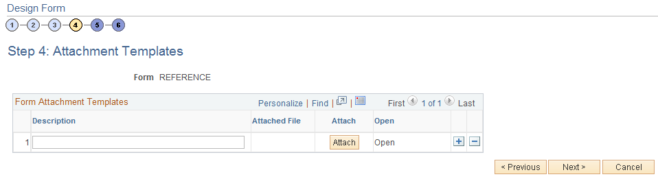

Use the Design Form - Step 4: Attachment Templates page (FORM_DSN_WZR_ATCH) to associate file attachments with a form.
Image: Design Form - Step 4: Attachment Templates page
This example illustrates the fields and controls on the Design Form - Step 4: Attachment Templates page. You can find definitions for the fields and controls later on this page.
Field or Control
Definition
Attach
Click to attach a file. In the window that appears, click the Browse button to navigate to and select the file, then click the Upload button.
Description
Enter a description for the file. If you leave this blank, the file name is used.
Displays the file name of the attached file.
Open
Click to open the attached file.

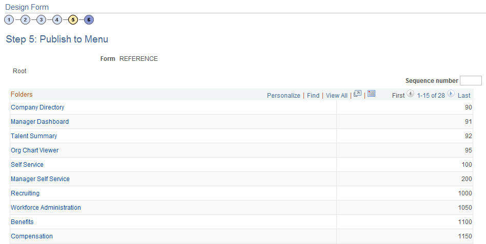

Use the Design Form - Step 5: Publish to Menu page (FORM_DSN_WZR_PRTL) to specify the menu location for a form.
Image: Design Form - Step 5: Publish to Menu page (1 of 2)
This example illustrates the fields and controls on the Design Form - Step 5: Publish to Menu page (1 of 2). You can find definitions for the fields and controls later on this page.
Image: Design Form - Step 5: Publish to Menu page (2 of 2)
This example illustrates the fields and controls on the Design Form - Step 5: Publish to Menu page (2 of 2). You can find definitions for the fields and controls later on this page.

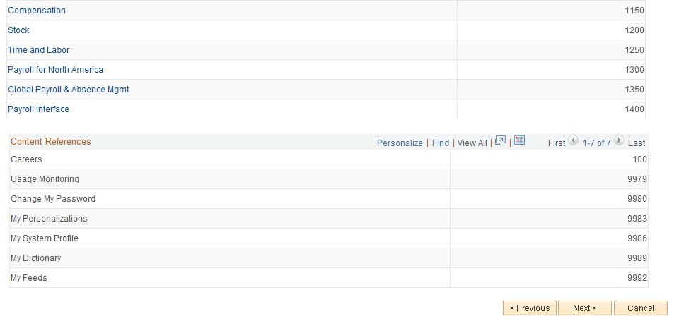

The menu hierarchy appears near the top of the page, below the form name; the highest level, Root, is equivalent to Main Menu in the menu hierarchy. Click the links to navigate to the level of the menu hierarchy in which you want the form to appear. Then, enter a value in the Sequence number to control the order in which it appears in the menu. In the example shown, the form will appear as the last item under Main Menu, Manager Self-Service, along with Review Forecasted Time and Travel and Expense Center.
Field or Control
Definition
Sequence number
Enter a value to specify the order within the menu that the form will appear. Items appear in ascending order.
Folders
This grid lists the folders at the currently selected menu level, and their associated sequence number. Click a folder to navigate to that folder level of the menu hierarchy.
Content References
This grid lists the available components at the selected level of the menu hierarchy and their associated sequence number. This is the level at which the form will appear in the menu.
Note: Only the components that your assigned role permits you to access appear in the grid.

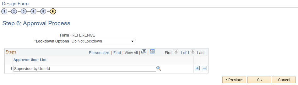

Use the Design Form - Step 6: Approval Process page (FORM_DSN_WZR_AW) to assign the approval workflow required for a form.
Image: Design Form - Step 6: Approval Process page
This example illustrates the fields and controls on the Design Form - Step 6: Approval Process page. You can find definitions for the fields and controls later on this page.
Field or Control
Definition
Lockdown Options
Specify if a form instance can be modified after it has been submitted, and under what conditions. Values are:
  • Do not lockdown: Select this option to allow changes to be made to the form instance at any time. This option enables users to update a form even after it has been submitted and approved.
  • Lockdown after submit: Select this option to prevent any changes to the form instance after it has been submitted (the approval status is Pending, or Approved.)
  • Lockdown after approval: Select this option to prevent any changes to the form instance after it has been approved (the approval status is Approved). Changes can still be made after it has been submitted, up until the time it is approved.
Note: If a form is integrated with PeopleSoft applications, the form cannot be modified after it has been posted to PeopleSoft transactional tables.
Approver User List
Insert rows and select the Approver User Lists required for this form. Approver paths must be sequential, branching is not supported.
Approver user lists are established using the User List Definition page (Enterprise Components > Approvals > Approvals > User List Setup).
see Defining Users for Approval Framework
After you have specified all the required Approver User Lists, click OK. The system automatically creates the approval Process Definition ID using the same name as the form name.
The predefined form approval configuration supports the following notification events: Route for Approval, Route for Review, On Final Approval and On Final Denial.
