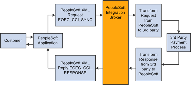

Image: EOEC_CCI_SYNC and EOEC_CCI_RESPONSE is used to integrate with a third-party credit processing vendor
The diagram shows the process flow for integration with a third-party credit processing vendor.
