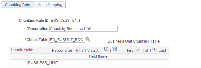

Use the Chunking Rule page (EO_CHUNKRULE) to define the chunking rule description.
Navigation
Image: Chunking Rule page
This example illustrates the fields and controls on the Chunking Rule page. You can find definitions for the fields and controls later on this page.
In message chunking, all data within the message contains the same break field. For example, if the break field is business unit, all transactions in the message are for the same business unit.

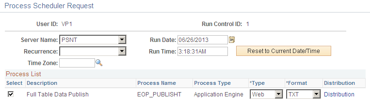

Performing Full Table Replication
Access the Full Data Publish page ().
Click the Run button on the Full Data Publish (EO_FULLDATAPUB) page to access and select the Full Table Data Publish check box and perform a full table replication.
Image: Process Scheduler Request page showing the Full Table Data Publish option
This example illustrates the fields and controls on the Process Scheduler Request page showing the Full Table Data Publish option. You can find definitions for the fields and controls later on this page.
