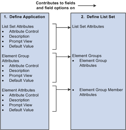

Setup Flow of Application Definitions and List Sets
Image: How application definitions contribute to list set setup
This diagram illustrates how setup on the Application Definition page determines which fields appear on the Define List Set page.
How to Set Up Applications and List Set Configurations
To build a list set using an application definition you must complete the following steps:
  1. Use the Define Application page to identify and label the attributes you want to define. These can be defined at the list set, element group, and element level. The system uses the information on the Define Application page to populate the List Set page.
  2. Use the Define Values for Attribute secondary page to specify additional values, as necessary.
  3. Use the Define List Set page to identify various element groups that you want to associate with the list set, and specify attribute values for each. If you defined any attributes at the list set level on the Define Applications page, the system displays them here. You may also create new element groups from this page if you have not previously done so.
  4. Use the Element Group Attributes secondary page to view or update element group and element attribute details.
