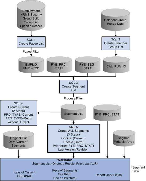

After you set up the input and output table details using the Define Report Data page, and map fields and define filters on the Report Data Process Details page, the system completes the following steps to select the absence results and populate the output tables:
  1. Select calendar groups.
  2. Select eligible payees using payee lists, group builds, security, and payee filter. If a payee filter was created, it is applied here.
  3. Join the payee process status table (GP_PYE_PRC_STAT) and the payee segment status table (GP_PYE_SEG_STAT).
  4. Select the original segments. If a process filter was created it is applied here.
  5. Insert the original, recalc, prior, and last version/revision segments into the worktable (GP_RPTW_TMP). The worktable now contains rows by payee for selected segments, recalculations, prior segments, and last version/revision segments. If a segment filter was created it is applied here.

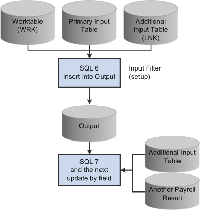

  6. Join the worktable, the primary input table, and the link table (the additional input table joined with the primary input table) according to the data on the Report Data Process Details page. The results are posted to the output table. Only the results derived from the worktable or the primary input table are populated. If an input filter was created it is applied here.
  7. Update the output table with data from the additional input tables.
Image: Overview of Generating Report Data 1
This diagram illustrates how the system generates the report data Worktable.
Image: Overview of Generating Report Data 2
This diagram illustrates how the system combines the data in the Worktable with the data from the Primary Input Table and Additional Input Table in the process of generating report data.
Four levels of filters exist: payee, process, segment, and input.
  • Payee Filter
    This SQL parameter is used to filter the population. It is applied when the selection is based on a specific record or employment table.
  • Process Filter
    This SQL parameter is used to filter the entire process in the original segments only. It can be based on any field in the payee process status or payee segment status tables. For example, "and COUNTRY = 'USA'" selects only U.S. absence results.
  • Segment Filter
    This field parameter is used to create a filter for every step of the process in every segment. It can be based on any field in the payee process status, the payee segment status, or the segment writable array table (if defined in the setup). For example, COMPANY 'GBI' makes a selection on the company GBI if COMPANY is stored in a segment writable array.
  • Input Filter
    This SQL filter is defined in the setup for each step used to filter the primary input table, the additional input table joined with the primary input table (the link table), or the worktable. Input filters can be used as a filter or as an additional join condition. For example, "and PRI.CALC_RSLT_VAL>0" selects only the positive results.
