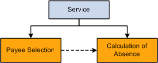

When you run an absence batch process, the first program that the system calls is the Service program. The Service program acts as the coordinator between the selection of payees to be processed and the calculation process. The Service program initiates the payee selection process. Once the payees are selected, the Service program passes control of the data that was created during the payee selection phase to the Calculation program.
Image: The Service program is the batch processing starting point
This diagram shows how the Service program coordinates the payee selection and calculation phases.
Before you can process absences, you must identify the payees that are to be processed. In Absence Management, this is called payee selection or payee identification. Payee selection is required in absence processing.
The payee selection process is separate from the calculation process. No rules are defined for payee selection that is associated with an absence calculation. The payee selection phase of the process only identifies the payees and creates the data that is later passed on to the calculation phase.
The pay calendar acts as the controlling function that coordinates and defines the payee selection and calculation processes. The Payroll/Absence Run Control also controls payee selection.
On the calendar definition page, you indicate whether you want active payees or listed payees selected. If you select active payees, you are offered a number of other defining choices. If you select listed payees, you insert the employee ID numbers for the payees that you want to select.
The payee selection process also uses retroactive and period segmentation triggers. Retroactive triggers can cause other periods besides the current absence period to be processed for a particular payee. Period segmentation triggers can cause the absence period to be split into segments, thus producing multiple calculations.
The result of the payee selection process is the creation of Process Status (GP_PYE_PRC_STAT) and Segment Status (GP_PYE_SEG_STAT) records. A Process Stat record is created for each payee for each calendar (including retroactive processes). A Segment Stat record is created for each payee for each segment in each calendar. The Process Stat and Segment Stat records are the storage places for the payee data that is related to the calendar that is being run. Essentially, the Process Stat and Segment Stat records list the payees and all the absence periods that are to be processed, including the current absence period and possible retroactive periods.

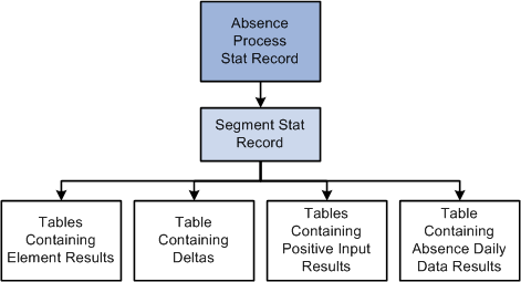

The goal of an absence batch processing run is to produce a set of output tables, where your important batch processing data results reside. Once you know the type of information that resides in the output tables that are generated by Absence Management, you can use those tables to produce reports and other data manipulations that are relevant to your organization's needs.
Image: Relationships between batch processing output tables
This diagram shows the relationships between the batch processing output tables.
Tables Generated by Payee Selection Process
The payee selection process generates the following tables:
  • Process Stat (status) record (GP_PYE_PRC_STAT).
    There is one Process Stat record for every EMPLID/EMPL_RCD combination per calendar.
    There is a one-to-one/many relationship between the Process Stat record and the Segment Stat record.
  • Segment Stat record (GP_PYE_SEG_STAT).
    The Segment Stat record is a child of the Process Stat record. There is one Segment Stat record for each gross to net within the calendar.
Tables Containing Element Results
The following tables contain element results:
  • Generated Positive Input (GP_GEN_PI_DATA).
    Contains the results of earnings and deductions after batch processing.
  • Other Elements (GP_RSLT_PIN).
    Contains the results of miscellaneous element resolutions after batch processing.
Table Containing Accumulator Results
The Accumulators table (GP_RSLT_ACUM) contains the results of accumulators after batch processing.
Table Containing Deltas
The Deltas table (GP_RSLT_DELTA) contains deltas, which are the differences between two element results. This data is often important for processing retroactivity. This table is a child table to the Segment Stat (segment status) table (GP_PYE_SEG_STAT), which is a child of the Process Stat table (GP_PYE_PRC_STAT).
Tables Containing Absence Daily Data Results
The following table contains the absence daily data results.
Absence Daily Data (GP_RSLT_ABS)
