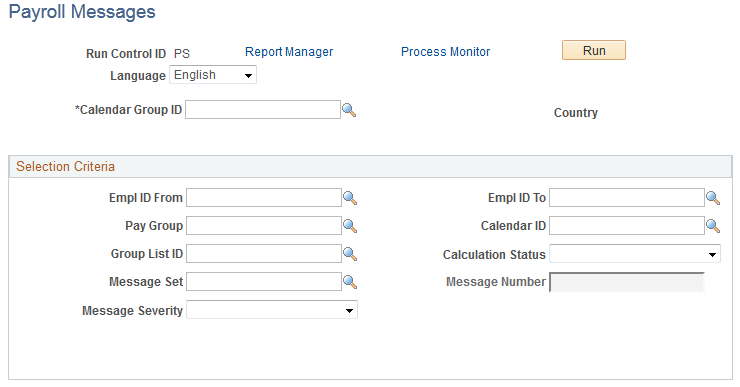

Use the Payroll Messages page (GP_GPSQR04_PNL) to run the Messages Report (GP000004) SQR process to identify payees who may need further editing to make it through finalization of the payroll.
Image: Payroll Messages page
This example illustrates the fields and controls on the Payroll Messages page.
Field or Control
Definition
Calendar Group ID
The calendar group to process.
EmplID From and EmplID To
Range of payees to process. Do not enter an EmplID To value without also entering and EmplID From value.
Pay Group
The pay group to process.
Calendar ID
The calendar to process.
Group List ID
Payees currently assigned to the group list ID will be processed.
Calculation Status
Calculation status to process.
Message Set
A specific message set can be selected, and the system will report only those messages in Absence Management.
Message Number
This field is available if you select a message set. Enter any valid message number.
Message Severity
Select Error or Warning to exclude informational messages and process terminating errors (message numbers under 300) from the report.
