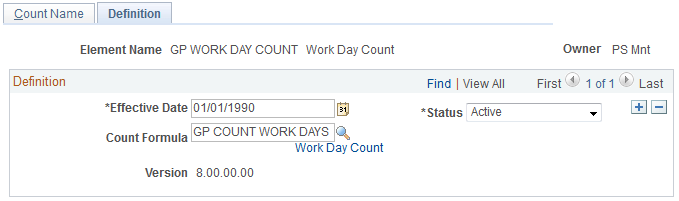

Use the Counts - Definition page (GP_COUNT) to define a count element.
Use this page to select an existing counting formula.
Navigation
Image: Counts - Definition page
This example illustrates the fields and controls on the Counts - Definition page.
Field or Control |
Definition |
| Count Formula |
Enter the name of the formula that performs the count. |
Field or Control |
Definition |
| <Formula Name> |
Click the link next to the Count Formula field to view the formula definition pages. |
