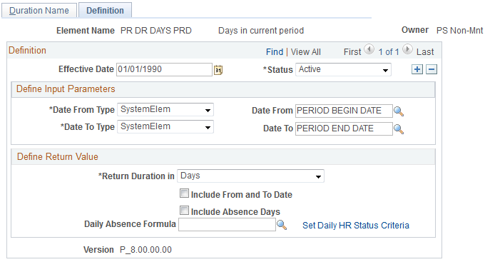

Use the Definition page (GP_DURATION) to define the number of days, months, or years between two dates.
Image: Durations - Definition page
This example illustrates the fields and controls on the Durations - Definition page.
Field or Control
Definition
Date From Type and Date To Type
Select the type of element that returns the Date From and Date To days. Valid values are: Bracket, Cal Date (calendar date), Date, Formula, System Elem (system element), and Variable.
Define the first and last day that the system is to include in the duration calculation.
Select the names of the elements that return the dates.
If the Date From date is the same as or greater than the Date Todate, the duration element resolves to zero.
Return Duration in
Select the unit of measure for the returned duration value. Valid values are:
  • Years - Select to return the duration in years. This is the default value.
  • Months - Select to return the duration in months.
  • Days - Select to return the duration in days.
    If you select Days, the Include From and To Date and Include Absence Days check boxes become available.
    Select the Include From and To Date check box to include the from and to dates in the calculation.
    For example, if the date from and date to are February 1, 2006 and February 5, 2006, and you select Include From and To Date, the system counts five days. If you don't select Include From and To Date, the system ignores the last day and returns a count of four. It also ignores the last day when it applies any instructions that you enter for including/excluding absences or including/excluding days based on HR status.
    (The system returns a value of zero when the begin date and end date are the same if you select Days but don't select Include From and To Date. It returns a value of one if you select Include From and To Date.)
Return Duration in Decimals
Select to receive the duration result in decimal form. .
If you select Return Duration in Decimals, the system converts durations to decimals after applying any rounding rules you may have defined.
The system expresses the results as follows, depending on Return Duration in value:
Years: The system returns years and the remaining number of months and days in decimal form. To calculate the decimal amount, the system divides the number of days by 30 and adds the result to the number of months. It then divides the number of months by 12 and adds the result to the number of years. For example, a duration of two years and one month returns a value of 2.08333.
Months: The system returns the number of months plus any additional days (partial month) in decimal form. Days are divided by 30 for calculation of the decimal value.
Days: Invalid.
Note: A month is defined as the period between the first day of one month and the first day of the next month. For example, January 1, 2006 to January 31, 2006 isn't a month—it's 30 days. To make it a month, select Return Duration in Decimals. The system returns 30 days, which equals one month. If you don't select Return Duration in Decimals and you're counting months, the result is zero.
Round months up from N days
Select and enter the number of days to which the system rounds the month.
Round years up from N months
Select and enter the number of the months to which the system rounds the year.
These fields are used to apply rounding rules to the result of your duration calculation. If you do not select a check box, no rounding occurs.
If you select either of these check boxes, and the months or days value is greater than the value that you enter, the calculation adds one year or one month, respectively.
For example, if Return Duration in is Years, and you select Round years up from N monthsand enter 6, the system returns a duration of 3 years and 6 months as a value of 4 years.
Note: The system applies the selected rounding rule before converting durations to decimals. If you select the Return Duration in Decimals check box and a rounding option, the system rounds up the months or years, as applicable, leaving no decimal value.
Field or Control
Definition
This check box becomes available when the Return Date In value is Days.
Select to include the from and to dates in the calculation.
Leave this check box cleared to exclude days. For example, if you leave this check box cleared, you can calculate a duration of time minus sick days.
Select the Include Absence Days check box to include absence days in the duration calculation.
Note: The system automatically excludes absences if you do not select Include Absence Days and specify a daily absence formula.
Daily Absence Formula
This field becomes available when the Return Date In value is Days.
To include or exclude the days that a payee is absent, select the formula that returns the number of absent days. To include the days that a payee is absent, you select the Include Absence Days check box. To exclude the days that a payee is absent, clear the Include Absence Days check box; now the number of absent days will be subtracted from the total duration count.
The formula is resolved for every day of absence daily history between the from and to dates (including those dates), and should return a 1 for each absence day it wants to count. The duration program cumulates the formula for each row of absence daily data (GP_RSLT_ABS, which is the output of the Absence Take process) and totals the results of the formula for all of the rows where the absence dates fall within the From and the To dates. (Keep in mind that the first and last day is considered only if the Include From and To Date check box is selected.)
Your formula must specify the take elements that you want to count. For example, you can use the absence type in an IF statement to count only sick time.
Your formula can call any of the system elements that are designed specifically for absence duration. These elements have the same names as those that are used to generate the absence daily data, but they end with the suffix DU. For example, you can use the system element, ABS END DATE DU to retrieve an absence end date for a particular absence.
Set Daily HR Status Criteria
Click this link to access the Set Daily HR Status Criteria page, where you can include or exclude time periods in the calculation based on HR status codes.
If you enter instructions to include daily absence data and include or exclude days based on status codes, the system performs two separate counts and combines the results. For example, if you include active days (based on HR status) and exclude absence days, the system counts the number of days the payee was active and subtracts the number of days the payee was absent.
Warning! Double counting can occur, depending on the instructions that you enter in the two group boxes. For example, if you include active days and days a payee is out sick, the days on which a payee is both active and sick are counted twice.

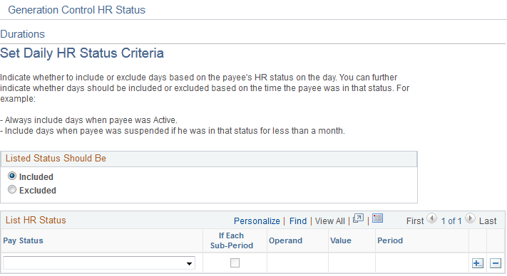

Use the Set Daily HR Status Criteria page (GP_DUR_STAT_SEC) to specify time periods for duration calculation, excluding or including them according to HR status codes.
Image: Set Daily HR Status Criteria page
This example illustrates the fields and controls on the Set Daily HR Status Criteria page.
If the unit of measure on the Durations - Definition page is set to Days, you can include or exclude time periods from the duration based on HR status codes. You can also specify minimum and maximum periods to check against.
Field or Control
Definition
Listed Status Should Be
Select Included or Excluded to include or exclude the status combinations that you specify in the List HR Status group box. Including or excluding status combinations has the following implications at processing time:
Include directs the system to include the period with that status combination in the duration.
Exclude directs the system to exclude the period with that status combination in the duration.
The code combinations that you enter are, as a group, either included or excluded, meaning that when you include specific status codes, those that you omit are automatically excluded. If you exclude certain codes, those that you don't exclude are automatically included.
The time period indicated includes the PS_JOB Effective Date.
Additional Period Definitions
Use the following fields to further define the periods that you want to include or exclude from the duration.
Field or Control
Definition
If Each Sub-Period
Select to include or exclude sub periods of a specified length from the duration. A sub period is a consecutive number of days that a payee's status remains unchanged.
Whether you can add sub periods together depends on whether the sub periods are in the same period. Sub periods are added together if they individually fulfill the criteria. The system calculates period by period; for each period, it checks the criteria that is defined on this page. If the criteria are met, the system considers the period for inclusion or exclusion. If the criteria are not met, the system ignores the period.
Operand
Select from <, <=, >, and >= to determine whether the time period is included in or excluded from the duration calculation. The operand is used with the Value and Period fields.
Value
The number of years, months, or days to include or exclude from the duration. This value is used with the operand to determine whether the length of time in the selected status is included in or excluded from the calculation.
Period
The period of time defined in the previous field: Days, Months, or Years.
