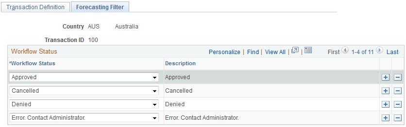

Forecasting Filter Page
GP_TXN_FILTER
Select the status of the absence self service absences that the system is to consider when you run the Forecasting process.

Use the Forecasting Filter page (GP_TXN_FILTER) to select the status of the absence self service absences that the system is to consider when you run the Forecasting process.
If integrating with Time and Labor, the status selected will be considered with forecasting processes on Timesheets also.
Image: Forecasting Filter page
This example illustrates the fields and controls on the Forecasting Filter page.
The system uses status values, such as Saved, Submitted, and Approved, to track and manage the approval of absence requests.
If you are using absence self service, use this page to specify which absence statuses the system is to consider when using forecasting. For example, you may want the forecasting process to evaluate only those absences that have a status of Approved. In this case, you would select Approved in the Workflow Status field.
Note: If integrating with Time and Labor, use this page to specify which absence statuses the system is to consider when using forecasting on Timesheets.
When an absence is requested through the Absence Event Entry page the Workflow Status field is set to blank. If you run the absence forecasting, such events will be considered during forecasting. If you have events entered through event entry and self service, when you run forecasting it will consider all the events entered through event entry plus those entered through self service and whose statuses were included in the Forecasting Filter page.
