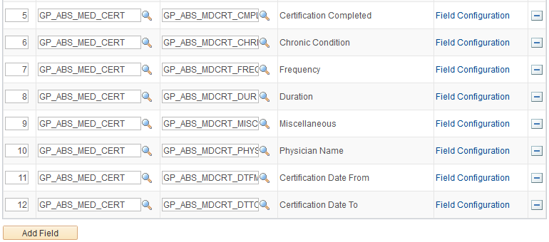

Section Fields
Field or Control
Definition
Record Alias
This refers to the field defined in the Record Definition. An alternate name for the table, the default value is the record name.
Field
The Record Field included on the page as part of the section.
Field Configuration
Click to access the Template Section Field Configuration page

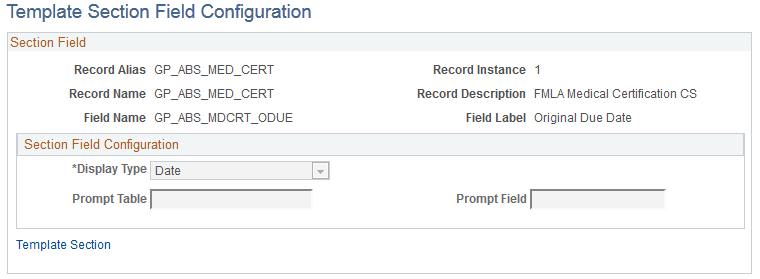

Use the Template Section Field Configuration page (GP_ABS_SECDTL`) to define the display and edit options per field.
Image: Template Section Field Configuration page
This example illustrates the fields and controls on the Template Section Field Configuration page.
Field or Control
Definition
Display Type
Select to choose the display type of the field. Values are: Short Edit Box, Long Edit Box, Long DropDown, Short DropDown, Short Prompt, Long Prompt, CheckBox, Date.
Prompt Table
Displays the name of the prompt table or substitution variable from the PeopleTools Record Definition table. This value can be modified.
Prompt Field
Enter the field used on the prompt table to select the value.

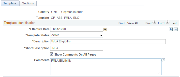

Use the Template Definition - Template page (GP_ABS_TEMPL_DEF) to enter template identification information.
Image: Template Definition - Template page
This example illustrates the fields and controls on the Template Definition - Template page.
Field or Control
Definition
Show Comments On All Pages
Select to show the comments as additional information on the Configurable Sections page within an extended absence.

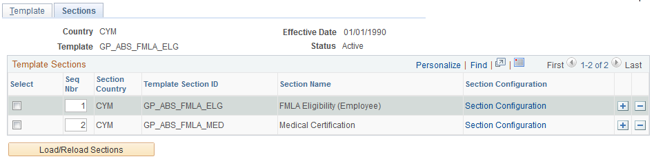

Use the Template Definition - Sections page (GP_ABS_TEMPL_DEF) to combine sections into a page in the extended absence feature.
Image: Template Definition - Sections page
This example illustrates the fields and controls on the Template Definition - Sections page.
Field or Control
Definition
Section Configuration
Click to access the Template Section Configuration page for the specified section.
Load/Reload Sections
Click to load the template sections from the template section setup table.

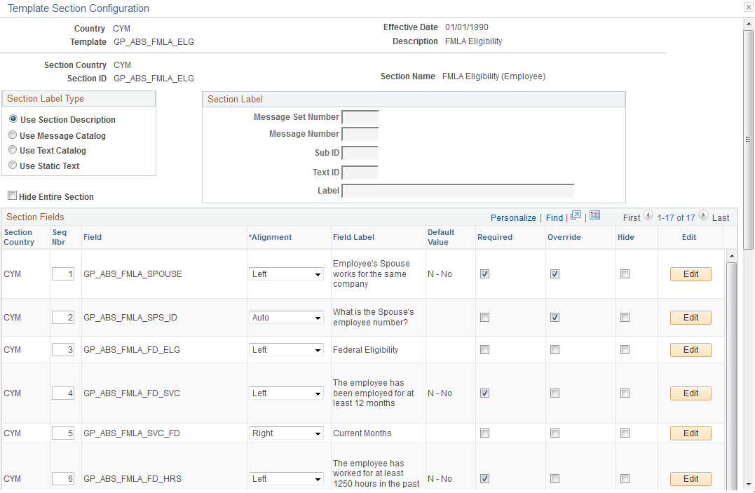

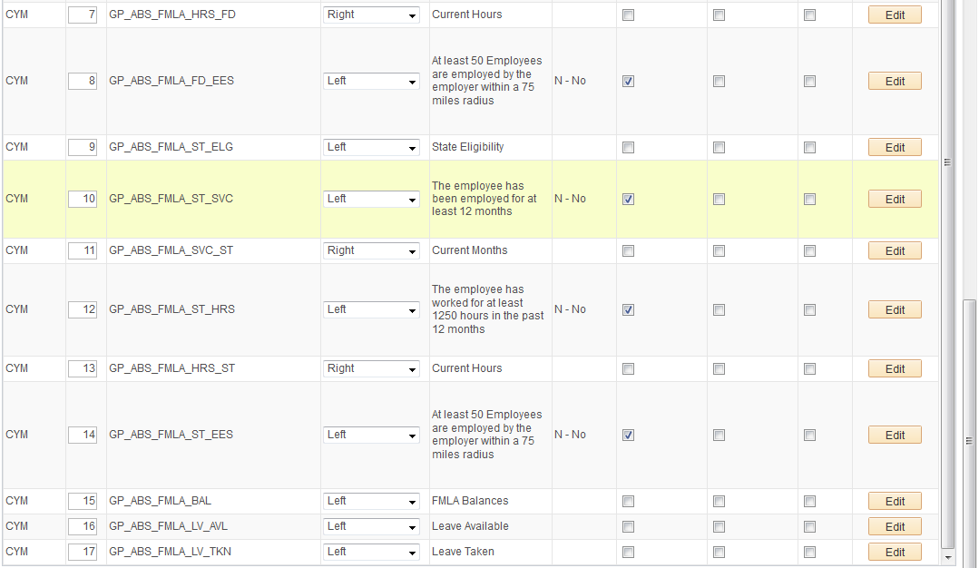

Use the Template Section Configuration page (GP_ABS_TMPL_FLDS) to define the section field properties.
Specify whether certain fields are required, display-only or hidden. You can also enter default values.
Image: Template Section Configuration page (1 of 2)
This example illustrates the fields and controls on the Template Section Configuration page (1 of 2).
Image: Template Section Configuration page (2 of 2)
This example illustrates the fields and controls on the Template Section Configuration page (2 of 2).
Field or Control
Definition
Section Label Type
Select the method used to choose the content of the section label in the specified template. Different fields in the Section Label region are available for entry depending upon the chosen Label Type. The following list describes the effect of choosing each Label Type on the Section Label region:
  • Selecting Use Section Description causes the system to use the description defined in the Section as the section heading on the extended absence configurable page. The user is not required to enter a label.
  • Selecting Use Message Catalog enables you to enter a Message Set Number and a Message Number.
  • Selecting Use Text Catalog enables you to enter a Sub ID and a Text ID.
  • Selecting Use Static Text enables you to enter text in the Label field.
Message Set Number and Message Number
Message sets and number settings come from the PeopleTools message set catalog. Select the message set and message number that you want to appear as the section label. You can select from the messages defined in the database. These fields are only available if you select the Use Message Catalog option in the Section Label Type region.
Sub ID and Text ID
Select the Text ID and Sub ID for the text catalog message you want to display as the section label. These fields are only available if you select the Use Text Catalog option in the Section Label Type region.
Label
Enter the text you want to appear as the section label. This field is only available if you select the Use Static Text option in the Section Label Type region.
Hide Entire Section
Select to specify that this section is hidden from the user.
For example, if certain information needs to be loaded into the buffer to support the validation, but does not need to be displayed.
Field
The Record Field selected in the section.
Alignment
Select the desired location of the field on the extended absence pages. You can specify that the field appears on the left or right side of the page, or indicate that the system should select the location, based on the available space. Values are: Left, Right, and Auto.
Field Label
Displays the field label used on the configurable page.
Default Value
The value that initially populates the record field.
Required
Defaulted from the Template Section Field Setup Table; can be overridden by the Template Administrator, but only if the default is No. A field required by definition of PeopleTools must remain required. However, a field that is not required by definition, can be made required on the template.
Override
Select to specify that the end user can enter or override the value of the specified field.
Hide
Select this field to hide the specified field from the end user.
Edit
Click to access the Section Field Default Value page.

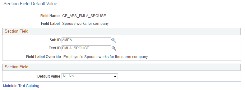

Use the Section Field Default Value page (GP_ABS_TMPL_FLDC) to specify the default value of record fields in a section.
Image: Section Field Default Value page
This example illustrates the fields and controls on the Section Field Default Value page.
Field or Control
Definition
Default Value
Enter the value that initially populates the record field.
