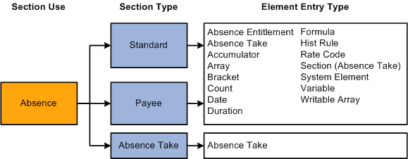

Sections are the building blocks for creating process lists. You create a section by giving it an element name, selecting the section type, and entering elements in processing order. Eligible elements depend on the section type.
Image: Section type determines which elements can be added to a section
This diagram shows the element types that you can include in each section type.
Note: Earnings and deductions are not included in process lists.

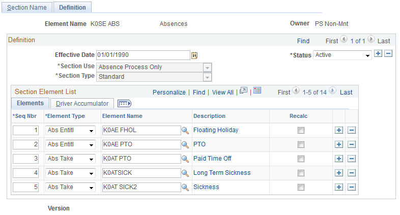

Use the Sections - Definition page (GP_SECTION) to select elements that constitute a section.
Image: Sections - Definition page
This example illustrates the fields and controls on the Sections - Definition page.
Field or Control
Definition
Section Use
This field displays Absence Process Only. You cannot change this value.
Section Type
Select the section type. This specifies how the Process List Manager processes the elements in this section. Options are Standard, Absence Take, and Payee Section.
If you select Payee Section, all fields become unavailable for entry. After saving this page, you can access the Section Overrides page and select the elements to be resolved for a particular payee.
Element Type
Select the type of element that you're adding to the section. Values depend on your Section Type selection:
Standard sections: Select Abs Entitl (frequency-based absence entitlement), Abs Take (absence take), Accumulator, Array, Bracket, Count, Date, Duration, Formula, Hist Rule (historical rule), Rate Code, Section, System Element, Variable, or Writable Array.
Absence take section: Select Abs Take.
Element Name
Enter the name of the element to include in the section. Selectable names depend on the element type.

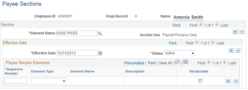

Use the Payee Sections page (GP_PYE_SECTION) to create a payee section for a process list.
Image: Payee Sections page
This example illustrates the fields and controls on the Payee Sections page.
Payee Sections page
Before using this page, create a payee section using the Sections - Section Name and Sections - Definition pages.
Field or Control
Definition
Element Name
Enter the name of the payee section, as defined on the Sections - Section Name page.
Section Use
When you select the element name, the system displays Absence, to identify the purpose of the section.
Payee Section Elements
Field or Control
Definition
Element Type
Select the type of element that you're adding to the section: Absence Entitlement (frequency-based entitlement elements), Absence Take, Accumulator, Array, Bracket, Count, Date, Duration, Formula, Historic Rule, Rate Code, Section - Absence Take, System Element, Variable, or Writable Array.
Element Name
Select the name of the element that you're adding to the section.
