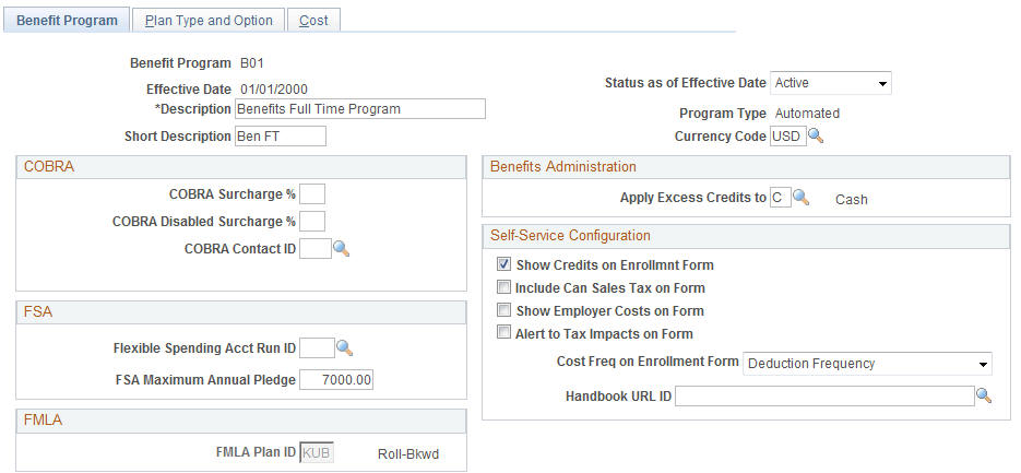

Use the Benefit Program Table - Benefit Program page (BEN_PROG_DEFN1) to define basic benefit program information.
Navigation
Image: Benefit Program Table - Benefit Program page
This example illustrates the fields and controls on the Benefit Program Table - Benefit Program page. You can find definitions for the fields and controls later on this page.
Field or Control |
Definition |
| Effective Date |
The date the row in the table becomes effective. This date determines when you can view and change information. |
| Status as of Effective Date |
Indicates whether a row in the table is Active or Inactive. Processes ignore benefit programs designated as Inactive, even if the effective date defines the program as current. |
| Program Type |
The type of program can be Manual or Automated. If you are using only the Manage Base Benefits business process, this option is automatically set to Manual. If you activate Benefits Administration on the Installation Table, it is automatically set to Automated. |
| Currency Code |
The type of currency that is used for this program's benefit and deduction calculations. |
COBRA
This group box defines the rules regarding the surcharge amounts that your organization imposes on COBRA (Consolidate Omnibus Budget Reconciliation Act) plans.
Field or Control |
Definition |
| COBRA Surcharge % (COBRA surcharge percentage) |
Enter the percentage amount of the benefit cost that you want added to the benefit cost. For example, if the cost of medical coverage is 100 USD and the COBRA surcharge % is 30%, the cost for medical coverage for someone on COBRA would be 130 USD. |
| COBRA Disabled Surcharge % (COBRA disabled surcharge percentage) |
If you want a different percentage amount for a disabled person, enter that percentage amount. If you leave the field blank, the surcharge amount entered in the COBRA Surcharge % field will be applied to a disabled person with COBRA coverage. |
FSA
For FSA (flexible spending account) Administration users. Use this group box to set up your organization's business rules for flexible spending accounts.
Field or Control |
Definition |
| Flexible Spending Acct Run ID (flexible spending account run ID) |
For FSA Administration users. Enter the FSA run ID that you created on the FSA Run Table. |
| FSA Maximum Annual Pledge |
Enter the maximum amount that an employee can contribute across all flexible spending accounts within the Benefit Program for a plan year. |
FMLA
Use this group box to define the rules for processing under FMLA (Family Medical Leave Act).
Field or Control |
Definition |
| FMLA Plan ID (FMLA plan identification) |
Enter the FMLA plan ID that you created on the FMLA Plan Table. |
This group box is available if Benefits Administration is activated on the Installation Table. If you are using flexible credits, it is used to define how the system will process excess flexible credit amounts when an employee does not designate a rollover election during benefit enrollment.
Field or Control |
Definition |
| Apply Excess Credits to |
The system can convert excess flexible credit amounts to: C (Cash) D (FSA-Dependent Care) F (Forfeit Excess Credit) H (FSA-Health Care) R (FSA Retirement Counseling) S (Savings-401(k)) |
Self-Service Configuration
Use this group box to define the rules for displaying and processing the PeopleSoft eBenefits application pages.
Field or Control |
Definition |
| Show Credits on Enrollmnt Form (show credits on enrollment form) |
Select if you want credit amounts to appear on the enrollment form. If you do not offer flexible credits, you may not want this heading to appear on the form. |
| Include Can Sales Tax on Form (include Canadian sales tax on form) |
Select if you want Canadian sales tax information to appear on the eBenefits Enrollment Summary page. |
| Show Employer Costs on Form |
Select to display the employer's contributions (costs) on the enrollment form |
| Alert to Tax Impacts on Form |
Select to alert the employee to any potential tax impacts (due to the employer's contributions) on the enrollment form. Most typically, this would be if a T-Tax (imputed income) component existed. |
| Cost Freq on Enrollment Form (cost frequency on enrollment form) |
This defines how the cost of the benefits appears on the enrollment form. Values are Annual: Displays the costs as annual amounts. Deduction: Displays the costs as per-pay-period amounts. |
| Handbook URL ID (handbook uniform resource locator identification) |
Enter the URL ID that connects to your benefit handbook. URL IDs are set up in the URL Table. |

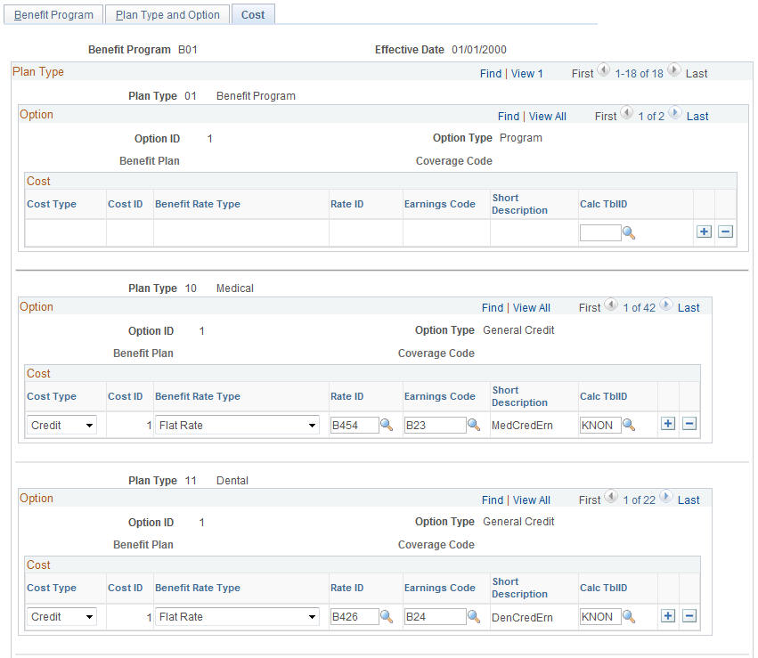

Use the Benefit Program Table - Cost page (BEN_PROG_DEFN3) to link a benefit program and plan type to rate and calculation rules.
Navigation
Image: Benefit Program Table - Cost page
This example illustrates the fields and controls on the Benefit Program Table - Cost page. You can find definitions for the fields and controls later on this page.
Cost
Use this group box to identify the rate and calculation rules for each benefit program and option combination.
Field or Control |
Definition |
| Cost Type |
Identifies the cost type for this plan type and benefit option combination. For Base Benefits, the value is always Price. The system calculates deductions for employees who select this option according to the deduction code linked to this benefit option. For Benefits Administration, the value can be Price or Credit. When you define a cost type as a credit, you must enter the appropriate earnings code. Use the earnings code to tell the system how to calculate the flexible credit earnings for a participant. Use a different earnings code for each benefit plan type within a benefit program. The system assigns the frequency of the additional pay based on the deduction code that you identify for this benefit option. |
| Cost ID |
When you enter a new cost row, this value is assigned automatically by the system and cannot be updated. |
| Benefit Rate Type |
Identifies the type of rate (flat amount, age-graded, and so on) associated with this plan type and benefit option combination. |
| Rate ID (rate identification) |
Identifies which specific rate table is linked with this plan type and benefit option combination. You need the identification number because you may have established multiple tables for a particular rate type. Only plan types 01 through 3X can use rates. |
| Earnings Code |
Applies only to credits. Identifies the earning code that might be tied to the plan type. |
| Calc TblID (calculation table identification) |
Identifies the calculation rule linked to the plan type and benefit option combination. |
Rate Availability by Plan Type
This table lists the rates types that you use for each plan type:

For some plan types, you will need to specify the proper Calculation Rules Table identification to ensure that the appropriate calculation rules are applied.
You don't have to indicate rates and calculation rules for all plan types. Certain rate types, on the other hand, require calculation rules.
Rate and Calculation Rule Requirements by Plan Type
This table lists the rate tables and calculation rules that you can use for different plan types:
Plan Type |
Rate Tables |
Calculation Rules Table |
01 |
Required |
Dependent on rate type. |
1x |
Required |
Required |
2x |
Required |
Required |
3x |
Required |
Required |
4x |
No |
Required |
5x |
No |
Required (reserved for future use), but not applied during calculations. |
6x |
No |
Not Used |
7x |
No |
Not Used |
8x |
No |
Not Used |
9x |
No |
Not Used |
Calculation Rule Requirements for Rate Types
Calculation rules are required for age-graded, flat-amount, salary-percentage, and service rate types.
