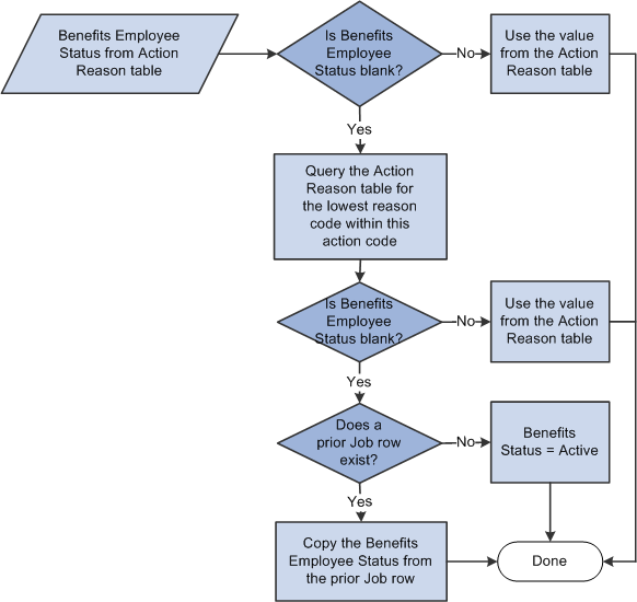

The following diagram illustrates how the system sets Benefits Employee Status by matching the action and action reason on the Job row to the action and action reason in the Action Reason table. If the Job row does not have an action reason, the system matches the reason to the entry in the Action Reason table that has a matching action and the lowest action reason value within that action.
Image: Process flow for how the system sets Benefits Employee Status by matching the entry in the Action Reason table
This image illustrates the process flow for how the system sets Benefits Employee Status by matching the entry in the Action Reason table.
The system carries Benefits Employee Status forward from the preceding Job row if the Benefits Employee Status field on the Action Reason table is blank or if no entries are in the Action Reason table that match the action on the Job row. Thus, certain action values and action reason values, such as Hire, Terminate, and Leave of Absence can explicitly affect the Benefits Employee Status while others, such as Transfer, Job Reclassification, and Demotion might not.
