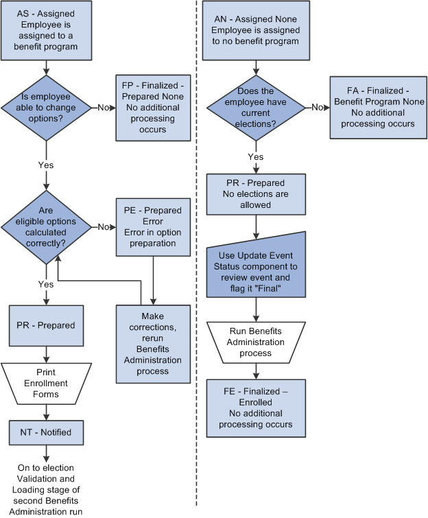

AE - Program Eligibility Assigned Error
Participant event is assigned to multiple programs.
The system cannot process the participant event through the next stage (option preparation) until you correct the errors. You'll most likely need to make corrections to participant personal, employment, and job information or to program eligibility information. Each time you run the Benefits Administration process, the system reevaluates AE events.
AN - Program Eligibility Assigned None
Participant event is not assigned to a benefit program.
During the option election phase of the process, the system determines whether the AN participant associated with the event has current elections that require termination due to loss of program eligibility. If not, the event is assigned to FA (Finalized - Assigned None) status and processing ends. If the participant does have elections, the system updates process status to PR (prepared). Before the system can terminate this event, you have to acknowledge it on the data entry pages.
The Find Terminations workflow process locates participant events at PR status that require termination.
AS - Program Eligibility Assigned
Participant event is assigned to a benefit program.
The event continues on to a process status of FP (Finalized - Prepared None), PE (Prepare Error), or PR, depending on the associated participant's eligibility for benefit options.
Note: You should not see the AN process status when the system completes the first run of the Benefits Administration process. The system uses this status value only during the Schedule and Program Assignment stage of the process. In option preparation, the next stage of the first run of Benefits Administration, the system moves events with an AN process status on to subsequent process status values like FA or PR.
In addition, if you see a set of events at the AS process status after Event Maintenance processing, employees are being processed who have more than one event assigned to them. In event maintenance, the system can assign and schedule all unprocessed events to a status of AS. However, because Benefits Administration can process only one event per participant at a time through option preparation and election validation, it must close those events and leave them behind at AS status until the open events are processed.

This table describes option preparation status values:
Process Status
Description
Next Processing Steps
FA - Finalized - Benefit Program None
Participant event has no program assignment and no current elections. Used for events assigned an AN process status during the Scheduling and Program Assignment and for which associated participants do not have current benefit elections.
No further processing occurs for this event. The online page description for this process status (on the Schedule Summary page, for example) is Program None.
FP - Finalized - Prepared None
System has assigned the participant event to a benefit program, but the associated participant is not allowed to elect any new options.
No further processing occurs for this participant event. The online page description for this process status (on the Schedule Summary page, for example) is Prepare None.
PE - Prepare Error
The system has encountered an error. Events are given a PE process status during option eligibility determination or calculation of credits.
To correct, you should make corrections to the personal, employment, job, and information of the associated participant or to plan and option eligibility information. Each time you run the Benefits Administration process, the system reevaluates PE events.
PR - Prepared
The system has calculated eligible options, credits, rates, and proof requirements for the participant associated with the event, and current elections have been identified for proof, eligibility level, and default processing. AN events that have current elections can also be brought to a status of PR.
For PE or AS events, processing stops. Enrollment forms should be created for and delivered to the participant associated with the event to bring the event to a process status of NT (notified).
For AN events, processing also stops. Review the event (a pending termination of benefits), confirm it by marking it for finalization, and then run the second phase of Benefits Administration. The event is brought to a process status of ET (Entered). The system brings the event to a process status of FE (Finalized - Enrolled) and automatically inserts termination rows for each of the associated participant's current elections.
NT - Notified
Election enrollment form has been distributed to the participant associated with the event. The system updates the event's process status to NT when you generate election forms for that participant through report BAS004.
Participants can advance to NT only if their previous process status was PR.
Participants need to complete their election forms and return them to the HR/Benefits department. When you enter the elections into the system with the data entry pages, the system advances the events to an ET (entered) process status.
Note: If you run an Open Enrollment process with Finalize selected, NT and PR events are brought to FE status, and the system follows event rules to determine whether current elections or defaults should be loaded into the associated participant's records.
The following two flowcharts illustrate how the system assigns process status values during option preparation. The flowchart on the left shows the process status flow for AS events, while the flowchart on the right shows the process status flow for AN events:
Image: Process status flow for option preparation
The following image illustrates the process status flow for option preparation.

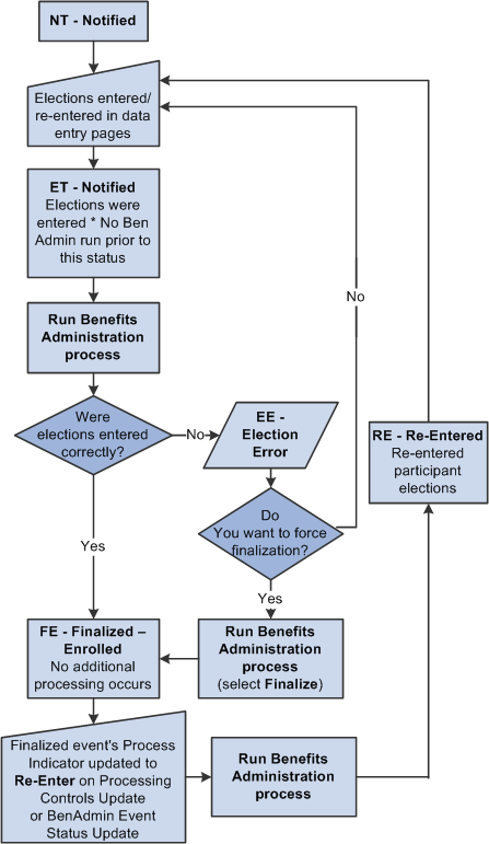

ET - Entered
A benefits administrator (or the employee through PeopleSoft eBenefits) has entered the participant's new elections into the system, and they are ready for validation by the Benefits Administration process.
Participant events with a process status of ET can have a prior process status of PR, NT, or RE (Reentered).
If no errors occur with the elections, the elections are posted to the appropriate benefit and payroll tables, and the system updates the process status to FE.
If errors occur, the status becomes EE.
If you run the Benefits Administration process with Finalize selected, EE participant events are brought to FE status, and the system goes through the normal validation and load procedure for all elections. If any of the employee's choices are invalid, event rules are consulted to determine whether current elections or defaults should be loaded.
EE - Election Error
The system encountered an error in processing the elections for the participant associated with the event. No elections are posted to the Manage Base Benefits business process tables.
Errors are posted to the Message table and are identified by participant and event.
The previous process status was either ET or EE.
No further processing occurs for this participant event. You need to correct the errors by reentering employee elections and run the Benefits Administration process again.
Alternatively, you can force finalize this participant event to finalize it with errors. The system loads the default values for the associated participant's erroneous benefit option elections. If a dependent/beneficiary or investment choice is in error, the system loads the employee's option choice but does not load the dependent/beneficiary or investment choice.
You can generate confirmation statements for participants whose events have an EE process status; the form indicates the plan information in error along with the valid plan choices.

RE - Re-Entered
Enables elections associated with processing for the participant event to be reentered after the participant event has been brought to a process status of FE.
Events are updated to RE status through the Update Event Status page.
After you update the elections in the data entry pages, the system updates the process status from RE to ET.
The following flowchart illustrates the process status flow for ET events and follows it through to the final process status of FE. It also shows how the system uses the RE process status:
Image: Process status flow for election entry, validation, loading, and reentry
This image describes the process status flow for election entry, validation, loading, and reentry.
