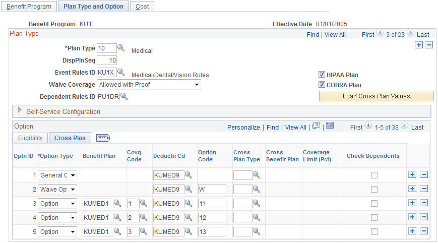

Use the Benefit Program Table - Plan Type and Option page: Cross Plan tab page (BEN_PROG_DEFN2) to link plan types to the benefit program and add important information about plan types.
Navigation
Select the Cross Plan tab in the Option group box.
Image: Benefit Program Table - Plan Type and Option page: Cross Plan tab
This example illustrates the fields and controls on the Benefit Program Table - Plan Type and Option page: Cross Plan tab. You can find definitions for the fields and controls later on this page.
Option: Cross Plan Tab
Field or Control |
Definition |
| Cross Plan Type |
Identifies the controlling plan that employees or dependents must be enrolled in before they are eligible for enrollment in the option being defined. This field is required for all other cross-plan validations. |
| Cross Benefit Plan |
The controlling benefit plan that is required for an employee to elect this option. If this field is blank, then any election in a benefit plan within the Cross Plan Type field meets the criteria for cross-plan validation. |
| Coverage Limit (Pct) (coverage limit percentage) |
Used primarily for life plan options to place a limit on the amount of coverage the enrollee (employee or dependent) can receive. This field becomes available after you attach a cross-plan type to a benefit plan. Note: During Benefits Administration validation processing, the system checks to ensure that the coverage elected or afforded under this benefit plan does not exceed the specified percentage of the coverage elected or afforded under the Cross Benefit plan. |
| Check Dependents |
When selected, this option informs the system to check that potential dependents (for the specified benefit plan or option) are also enrolled as dependents for the specified Cross Benefit plan. This is available only to 1x plan types and becomes available after you associate a cross-plan type with a benefit plan. |
