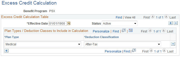

Use the Excess Credit Calculation page (EXCESS_CRDT_CALC) to enter excess credit calculations.
Image: Excess Credit Calculation
This image shows the Excess Credit Calculation page.
Enter the plan types and deduction classifications that you want the system to include when calculating the excess credit amount.
