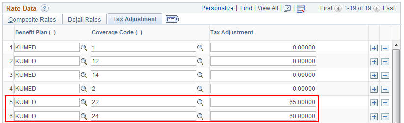

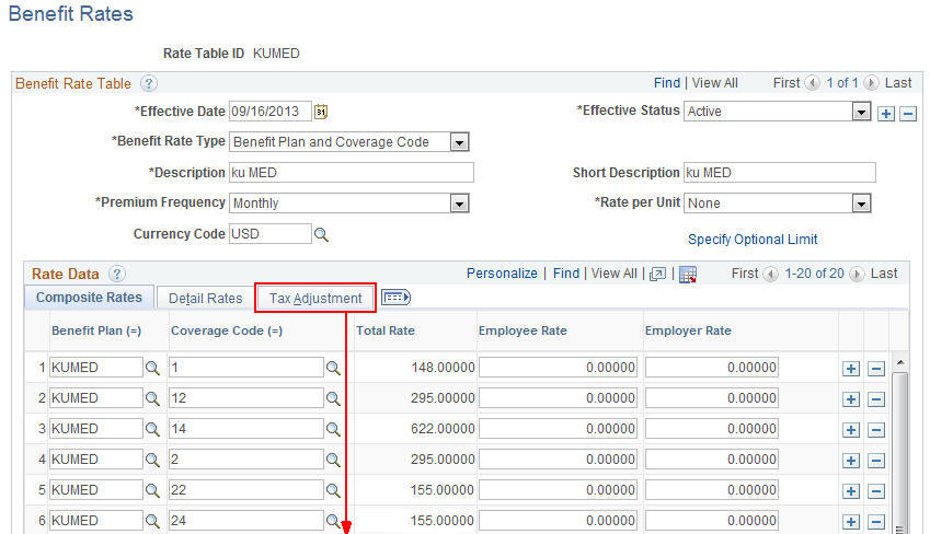

For Health Plans, define tax adjustment rates for coverage codes 22 and 24. Other coverage codes do not require tax adjustment rates.
Image: Benefit Rates page
This example illustrates the fields and controls on the Benefit Rates page.
Benefit Rates page
Image: Benefit Rates — Tax Adjustment page
This example illustrates the fields and controls on the Benefit Rates — Tax Adjustment page.
Benefit Rates - Tax Adjustment page

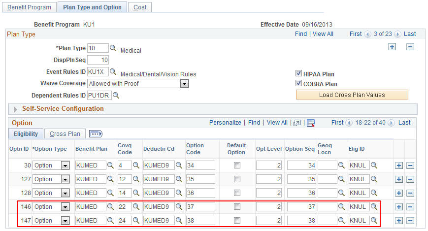

On the Benefits Program Table for Health Plans, add options for coverage codes 22 and 24.
Note: Since coverage codes associated with same sex and heterosexual marriage can be identified, the same Benefit Rates Table can be used for both, but with a different set of tax adjustment rate entries accordingly.
Image: Benefit Program — Plan Type and Option page
This example illustrates the fields and controls on the Benefit Program — Plan Type and Option page.
Benefit Program - Plan Type and Option page
Image: Benefit Program page — Options
This example illustrates the fields and controls on the Benefit Program page for coverage codes 22 and 24.
Benefit Program page - Options

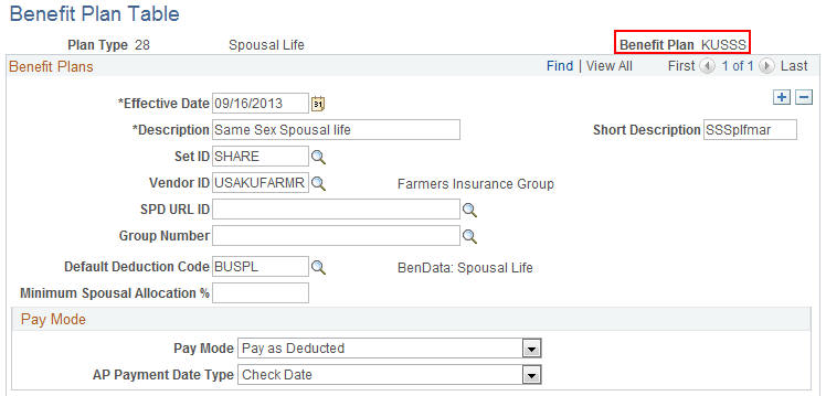

Life Insurance 2X plans do not use health coverage codes. Set up separate benefit plans for same-sex spouse in order to use different benefit rates for spouse and same-sex spouse.
Note: The following screenshots provide sample setup for spousal life insurance plans.
Image: Benefit Plan Table page
This example illustrates the fields and controls on the Benefit Plan Table page.

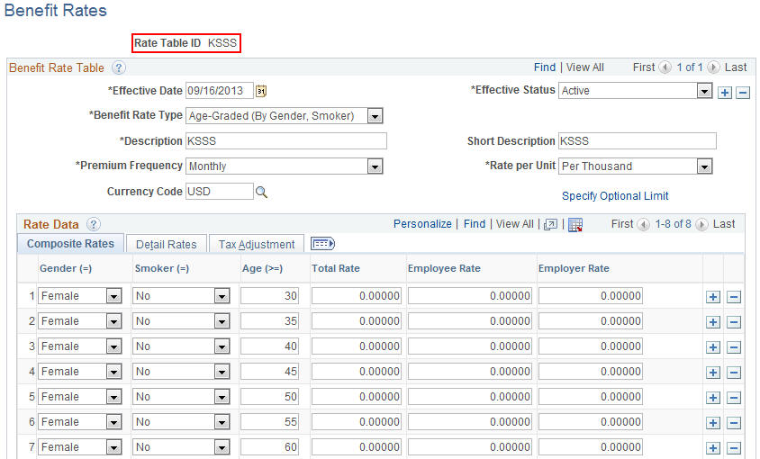

Additionally, create a new benefit rate ID on the Benefit Rates Table with tax adjustment amounts for same-sex spouse.
Benefit Rates page

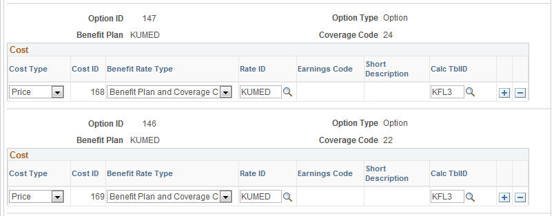

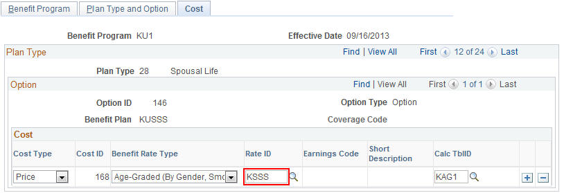

Add option entries for same-sex spouse using a separate benefit plan and different benefit rate ID.
Image: Benefit Program — Cost page
This example illustrates the fields and controls on the Benefit Program — Cost page.
Benefit Program - Cost page
