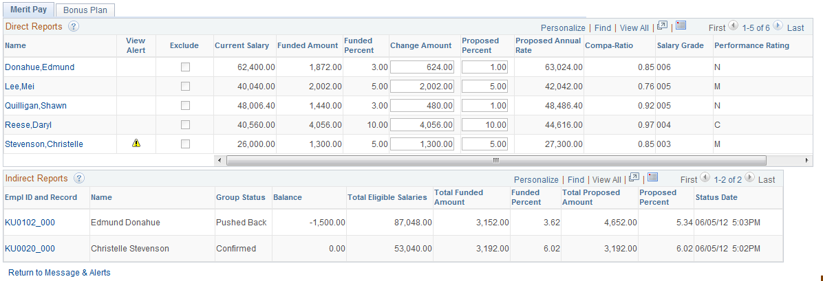

The system generates alert messages when employees with one or more of the preselected job changes were identified during the open cycle. These alerts are available when managers and administrators access the Allocate Compensation component, and they are displayed next to the associated employees in the View Alert column:
Image: Display of job change alert on the Allocate Compensation page
This example illustrates the fields and controls on the Display of job change alert on the Allocate Compensation page.

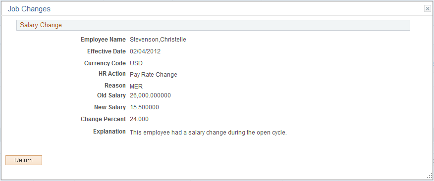

To ensure that these alerts are always visible as they become available, the View Alert field (under the Grid Display Settings section of the Define Compensation Cycles - Self-service page), where the alert icons are shown, is selected by default. When a manager clicks an alert icon, a modal window appears, and it lists details pertaining to the corresponding job change:
Image: Display of job change alert message after clicking an alert icon
This example illustrates the fields and controls on the Display of job change alert message after clicking an alert icon.
With this information in hand, the manager can allocate compensation amounts to his or her reports appropriately.

After building the cycle, the administrator opens it up so that the manager of the cycle can begin allocating compensation for employees included in the cycle. During the open period, employee Christelle Stevenson has been given a salary increase with an effective date of February 04 of this year. The increase is recorded in her job data as a new row and it is unrelated to this open compensation cycle.
To make sure that the manager is aware of all the salary changes that may have taken place during the open cycle, the administrator kicks off the job change process. After the process has run successfully, the process logs Christelle’s salary job change in the WCS_CYC_RULE_INFO log file.
As a result, when the manager accesses the Allocate Compensation page to view and edit the team’s compensation proposals at runtime, the View Alert icon appears on Christelle’s row. The manager can click the icon to see the detail of the alert (in this case about the February 04 salary update). The proposed amount and percent are still displayed for Christelle because the Exclude option is not selected for the salary job change in the setup; and the manager can adjust the values manually based on company guidelines.
