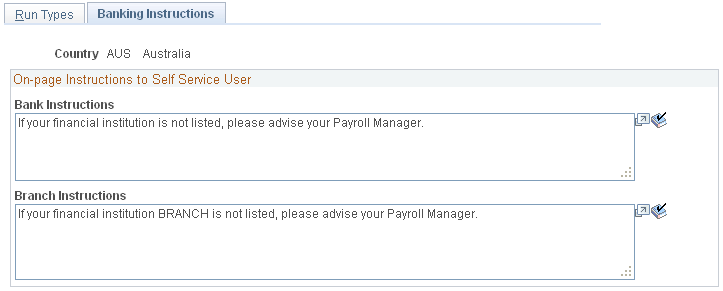

Use the Run Types page (GP_SS_NPD_CONFIG) to set up the net pay distribution options that are available to employees in the self-service Pay Distribution Instructions transaction.
Image: Run Types page
This example illustrates the fields and controls on the Run Types page.
