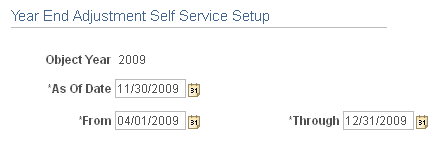

Image: Year End Adjustment Self Service Setup page
This example illustrates the fields and controls on the Year End Adjustment Self Service Setup page.
Field or Control
Definition
Object Year
The year that is being adjusted.
As Of Date
The system uses this date when retrieving current information from effective-dated tables. The system also uses this date as the effective date when loading YEA self-service data into tables.
From and Through
Enter the begin and end dates of the period that employees can access the YEA data self-service transaction.
