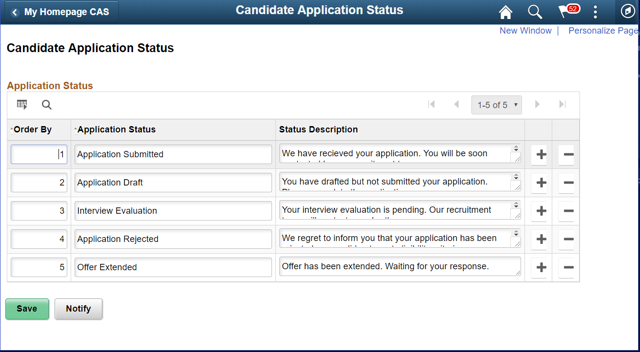

Image: Candidate Application Status page
This example illustrates the fields and controls on the Candidate Application Status page.
Field or Control |
Definition |
| Order By |
Align the ordering of statuses in a logical sequence within the drop-down field when mapping candidate application statuses on the Status Area page. |
| Application Status |
Enter the status of the application within 30 characters and with only alpha characters. No numerical or special characters allowed. |
| Status Description |
Provide a description of the status. |
Add an application status row. |
Remove an existing application status row. |
Note: It is recommended to make changes only after deactivating the Candidate Application Status feature in the Status Area page and after unmapping the statuses for which the changes have to be done. Once changes are done in the Candidate Application Status page, the Candidate Application Status feature in the Status Area page can be activated after the re-mapping.
