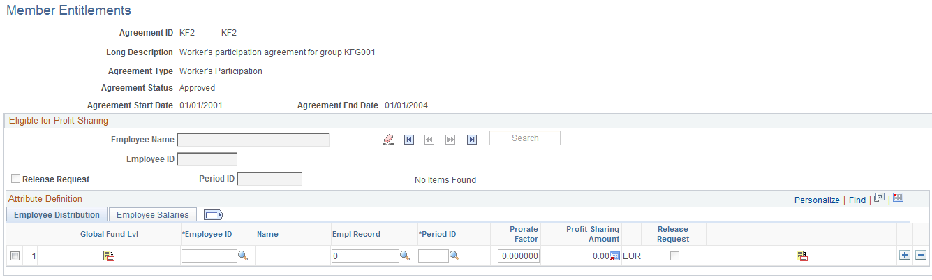

Use the Member Entitlements page (WP_PSHRG_MAIN_TBL) to review the results of the profit sharing processes for a selected agreement.
Image: Member Entitlements page - Employee Distribution tab
This example illustrates the fields and controls on the Member Entitlements page - Employee Distribution tab. You can find definitions for the fields and controls later on this page.
After you run the Extract Eligible Employees process for a selected agreement, the system populates this page with employees who are eligible for a share of the global fund. The Extract Eligible Employees process compiles this list using the eligibility criteria specified in the agreement.
You can add or remove employees from the list of eligible employees if necessary. However, if you add employees manually you must enter their salary information. If you add an employee after running the Distribute Global Funds process, you must rerun the process or enter the employee's fund amount.
Field or Control
Definition
Release Request
Select this check box if you want to search for employees who have requested a fund release.
Period ID
Displays the reference period for which the employee is eligible.
Global Fund Lvl Global Fund Lvl
Click to view the computation level and funding formula that was used to calculate the global fund. This button is available for worker's participation agreements only.
Prorate Factor
Displays the proration factor calculated by the Extract Eligible Employees process by dividing the employee's working days by total working days in period. This factor is used later by the Distribute Global Funds process. One of the distribution methods for profit sharing is based on the number of days worked by the employee during the reference period.
If you update the proration factor, the system displays a message warning you that the profit-sharing amount for the employee may not be consistent with the changed proration factor. If you have already run the Distribute Global Funds process, the employee's profit sharing is based on the previous value. In this case, you must manually update the profit-sharing amount or rerun the Distribute Global Funds process.
Profit-Sharing Amount
Displays the amount the employee will receive from profit sharing if you have run the Distribute Global Funds process for the reference period. To change the employee's fund amounts, click the Employee Release Detail button.
Release Request
This check box is automatically selected if the employee has submitted a fund release request. Once you approve or reject a request, the system deselects the check box. Click the Employee Release Detail button to view the request and approve or reject it.
Release Detail Release Detail
Click to check whether the employee has requested a fund release.

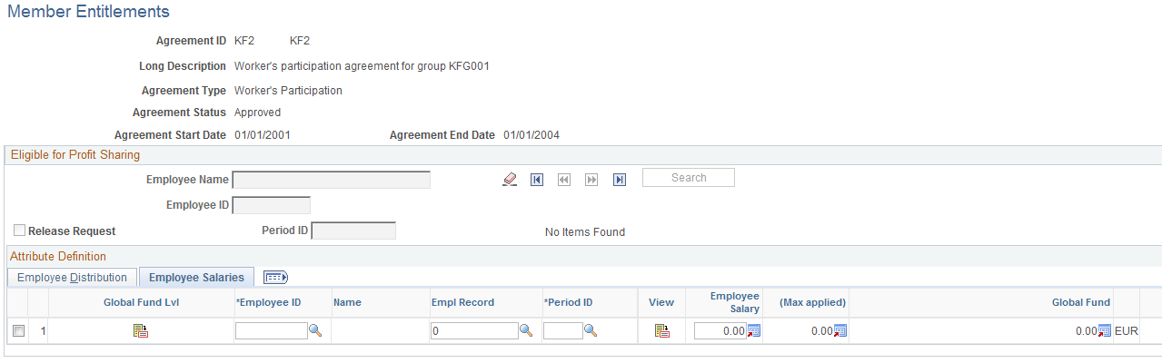

Employee Salaries
Image: Member Entitlements page - Employee Salaries tab
This example illustrates the fields and controls on the Member Entitlements page - Employee Salaries tab. You can find definitions for the fields and controls later on this page.
Field or Control
Definition
Employee Salary
Displays the employee's salary. This information is imported from PeopleSoft Global Payroll for France or from another payroll system when you run the Extract Eligible Employees process.
(Max applied) (maximum applied)
Displays the employee's salary, after the maximum limit is applied. This value is calculated by the Extract Eligible Employees process using the Individual Salary Limit Formula specified in the agreement.
Global Fund
Displays the global fund calculated by the Compute Global Fund process.

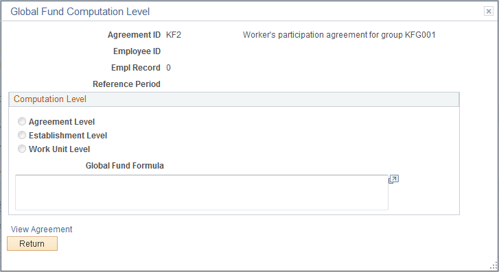

Use the Global Fund Computation Level page (WP_PSHRG_EEDTL_SEC) to view the global fund formula used to calculate the selected employee's global fund.
This page is available for worker's participation agreements only.
Image: Global Fund Computation Level page
This example illustrates the fields and controls on the Global Fund Computation Level page. You can find definitions for the fields and controls later on this page.
Field or Control
Definition
Reference Period
Displays the period ID shown on the Member Entitlements page.
View Agreement
Click this link to view the agreement definition pages.
Computation Level
Worker's participation agreements can have multiple formulas for calculating global funds. Formulas are defined for all employees associated with the agreement, for employees in specific establishments, or employees in specific work units. This group box displays the formula that applies to the selected employee.
Field or Control
Definition
Global Fund Formula
Displays the funding formula used to calculate the employee's global fund. The funding formulas are defined on the Computation page (Define Agreement component).

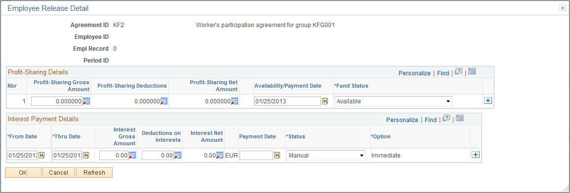

Use the Employee Release Detail page (WP_PSHRG_VSTDT_SEC) to view full details of the employee's profit sharing amount, interest (if applicable), and fund release requests.
This page gives a breakdown of the gross amount, deductions, and net amount. You can adjust calculated amounts, if required, and approve or reject the employee's fund release requests.
Image: Employee Release Detail page
This example illustrates the fields and controls on the Employee Release Detail page. You can find definitions for the fields and controls later on this page.
Release Request
This group box appears if the selected employee has submitted a request to release funds. It is relevant for profit-sharing agreements only.
Field or Control
Definition
Release Request
Indicates the type of fund release requested. Values are:
Amount: Employee requested release of a specific amount shown in the Release Amount field.
Total: Employee requested release of the entire fund. The total is shown in the Release Amount field.
Release Date
Displays the date when the employee submitted the fund release request.
Event
Displays the event that the employee selected for the fund request and the date on which the event occurred is shown in the Event Date field.
Request Status
Displays the status of the fund release request: New for a new request, Approved or Rejected.
Approve
Click to approve the request. This triggers workflow to notify the employee that the request is approved and changes the fund status to Request Payment.
Reject
Click to reject the request. This triggers workflow to notify the employee that the request was rejected.
Profit Sharing Details
Field or Control
Definition
Profit-Sharing Gross Amount
Displays the employee's fund calculated by the Distribute Global Funds process.
Profit-Sharing Deductions
Displays the deductions on the employee's fund that are calculated by the Process Interest and Payment process.
Profit-Sharing Net Amount
Displays the amount payable to the employee after deductions are made.
Availability/Payment Date
Displays the date that the employee is due to receive payment or the date on which funds become available as follows:
  • If the Fund Status is Entitled, this field shows the date on which funds are available to employees.
    Employees can request fund release without conditions from this date.
  • If the Fund Status is Request Payment, Sent to Payroll, or Paid this field shows the payment date.
The date is defined by the Distribute Global Funds process and the Process Interest and Payment process. You can override it if Fund Status is one of these values: Entitled, Available, Request Payment, Error, or Canceled.
Fund Status
Displays the fund status that the Distribute Global Funds process and the Process Interest and Payment process have assigned, but you can change the status as required:
Entitled: Indicates that the employee's fund has been calculated but the money is unavailable. This status applies to profit-sharing agreement types only.
Available: Indicates that the employee's fund is available. For worker's participation agreements, the fund is available as soon as it is calculated. For profit-sharing agreements, funds are available after the end of the unavailability period defined for the agreement.
Canceled: Cancels the profit-sharing amount. Use this status when you find an error in an employee's fund after running the Distribute Global Funds process. To correct such a problem, you cannot run the process again or delete the employee data. Instead, set the fund status to Canceled and insert a new row for the employee with the correct amount. Using the Canceled status you can track the cancellation and the manual adjustments.
Sent to Payroll: Indicates that the Process Interest and Payment process has run and the profit-sharing amount has been sent to Global Payroll for France.
Posted to Account: Indicates that funds have been transferred to an external organization. The financial organization is defined in the Define Agreement component. Terminated employees can override the default organization for transfer of their entitlement to their new company fund.
Paid: Indicates that the payment has been processed by your payroll system. If you have Global Payroll for France installed and you're using Company Investment method, the Process Interest and Payment process sets the status to Paid when the payment is processed. If you have any other investment method, you must set the status to Paid manually when the payment is processed.
Error: Indicates that the Process Interest and Payment process could not process the payment.
Request Payment: Indicates that the funds are waiting to be processed.
Transfer to Account: Indicates that funds are due to be transferred to an external organization. Once the transfer is complete, you need to set the status to Posted to Account to track the funds.
Interest Payment Details
This group box appears for profit-sharing agreements with the Company Investment method selected. These amounts are calculated by the Process Interest and Payment process.
Field or Control
Definition
From Date and Thru Date
Defines the period for which interest has been calculated. Interest is calculated yearly during the period when funds are unavailable.
Interest Gross Amount
The interest due on the global fund before deductions are taken.
Deductions on Interest
The deductions on the interest.
Interest Net Amount
The interest payable to the employee after deductions are made.
Payment/Reinvestment Date
Depending on the interest status, this field shows one of three dates: the date that the employee is due to receive the interest payment, the date on which the payment was made, or the date on which the interest is reinvested.
Status
Interest status. Values are:
Canceled: Cancels the interest. Use this status when you find an error in an employee's interest after running the Distribute Global Funds process. To correct such a problem, you cannot run the process again or delete the employee data. Instead, set the interest status to Canceled and insert a new row for the employee with the correct amount.
Entitled: Indicates that the interest has been calculated and is available.
Reinvested: Indicates that interest has been added to the global funds and isn't paid immediately to the employee.
Manual: Use this status when you enter the interest amount manually.
Sent to Payroll: Indicates that the Process Interest and Payment process has run and the interest payment has been sent to Global Payroll for France.
Paid: Indicates that the interest payment has been processed by your payroll system. The Process Interest and Payment process sets the status to Paid when the interest payment is processed.
Error: Indicates that the Process Interest and Payment process could not process the interest payment.
Option
Displays the interest reinvestment method selected. This is either the default method for the agreement or the method selected by the employee. You can override the value.
