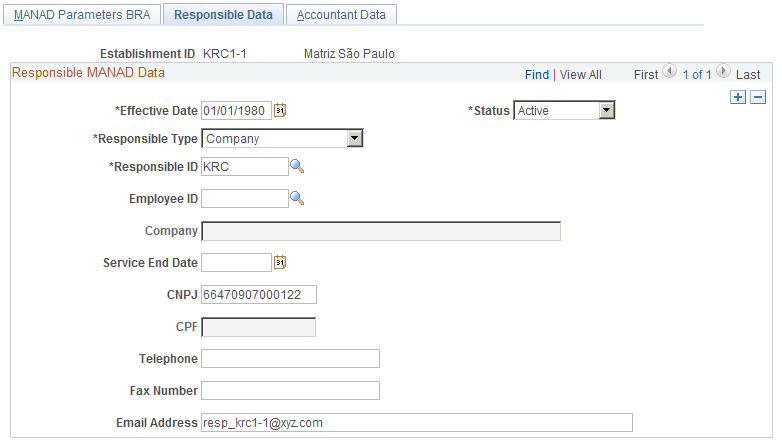

Use the Responsible Data page (GPBR_MANAD_RESP) to enter responsible data for the MANAD report.
Navigation
Image: Responsible Data page
This example illustrates the fields and controls on the Responsible Data page.
Use this page to enter data for use in Record 0100 in the MANAD report.

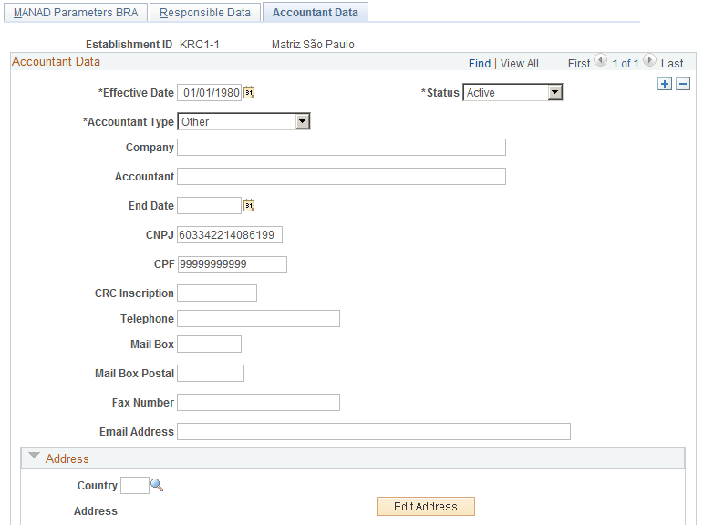

Use the Accountant Data page (GPBR_MANAD_ACCT) to enter accountant data for the MANAD report
Navigation
Image: Accountant Data page
This example illustrates the fields and controls on the Accountant Data page.
Information entered on this page is used to create Record 0050 for all existing accounting responsible entities for the required period specified for issuing the exportation file.
If the end date of the accounting service is not specified on this page, the system derives the end date by subtracting one day from the begin date of the next responsible entity.
