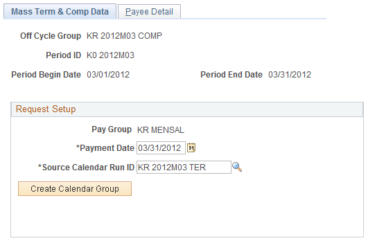

Use the Mass Term & Comp Data page (GPBR_MASS_TER_COMP) to specify calendar information for the mass termination or complementary termination process.
Navigation
Image: Mass Term & Comp Data page
This example illustrates the fields and controls on the Mass Term & Comp Data page.
The page layout of the Mass Term & Comp Data page is identical to the Mass Term Simulation Data Page.
Field or Control |
Definition |
| Off Cycle Group |
Displays the name of the off cycle group that was specified earlier for the request. |
| Period ID |
Displays the selected period for the process. The period needs to be defined in the system before it can be selected. The system populates the begin and end dates on this page based on the selected period. |
| Payment Date |
Enter the payment date for the mass process. |
| Source Calendar Run ID |
Select the calendar group that was created for the mass process. |
| Create Calendar Group or Edit Calendar Group |
Click to access the Calendar Groups page to create or update a calendar group for processing off cycle transactions. Once the calendar group is created, the button label becomes Edit Calendar Group, which you click to edit the calendar group that is already created. Note: (For complementary termination) Make sure that the Process retro triggers option is selected for the calendar group. |
| Processing Status |
Displays the latest’s payroll calculation process status. |

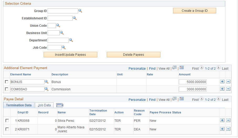

Selection Criteria
Field or Control |
Definition |
| Group ID |
Select an existing group of payees to be used for the selected process. These groups are established using the group build feature. You can also create a new group by clicking the Create a Group ID button. If you select a group, the rest of the fields are unavailable for edits. This field is disabled when you use any of the following filters to select employees for the process. |
| Create a Group ID |
Click to create a group for use in the selected process. |
| Establishment ID |
Select an establishment as a filter for its associated payees to be included the selected process. |
| Union Code |
Select a union as filter for its associated payees to be included the selected process. |
| Business Unit |
Select a business unit as filter for its associated payees to be included in the selected process. You need to select a business unit prior to selecting a department or a job code as the additional filter. |
| Department |
Select a department as an additional filter for its associated payees to be included the selected process. |
| Job Code |
Select a job code as an additional filter for its associated payees to be included the selected process. |
| Insert/Update Payees |
Click to populate the Payee Detail section with payees that meet the specific selection criteria. |
| Delete Payees |
Click to remove payees from the Payee Detail section. |
Additional Element Payment
Field or Control |
Definition |
| Element Name |
Enter additional earning elements that needs to be paid as part of the selected process. |
| Unit, Rate, and Amount |
Enter the unit, rate, and amount as necessary. |
Payee Detail
This section lists the payees that are populated by the system based on the specified selection criteria. You can also add payees manually.
The system populates this section with information that is specified in other sections (for example, termination data and job data) on this page.
Note: Make sure that the termination data is entered in the Job Data component for employees in order for the mass termination and complementary termination process to run properly.

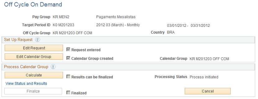

Use the Off Cycle On Demand page (GP_ONDEMAND) to create the off cycle requests for the mass termination or complementary termination process.
Navigation
Click the Off Cycle Group button on the Payee Detail page.
Image: Off Cycle On Demand page (termination and complementary termination process)
This example illustrates the fields and controls on the Off Cycle On Demand page (termination and complementary termination process).
The process uses the off cycle advance payment functionality that is provided by Global Payroll core architecture to calculate earnings and deductions for terminated payees outside of the normal payroll cycle.
Click the Create Request button to add a request for the off cycle process. The button label is changed to Edit Request for you to edit the request, after it is created.
Click the Calculate button to calculate the off cycle request.
For more information about off cycle processing and steps for entering off cycle requests, see Understanding Off Cycle Processing.
