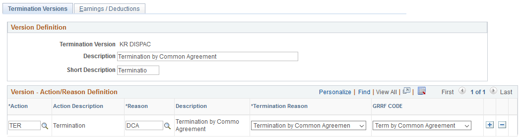

  1. Define your termination versions on the Termination Versions page.
  2. On the same page, define the associated actions/reasons that will trigger payment.

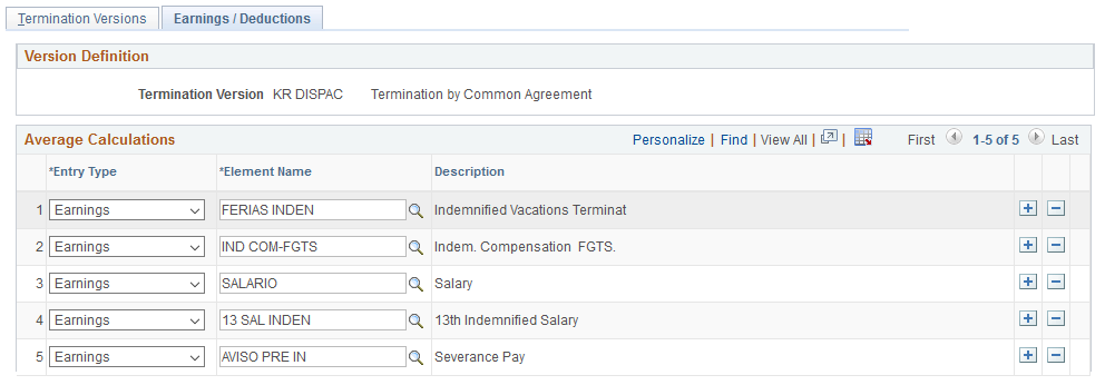

  3. On the Earning/Deductions page, associate each earning or deduction with a corresponding termination version.

Use the Termination Versions page (GPBR_TERM_ACTN_RSN) to define termination versions and the qualifying actions and reasons for triggering termination pay.
Image: Termination Versions page
This example illustrates the fields and controls on the Termination Versions page.
Note: (For terminations by common agreement) Global Payroll for Brazil delivers a termination reason (Termination by Common Agreement) and GRRF code (Term by Common Agreement) to support terminations that are mutually agreed by employers and employees.

Action
Specify the action that triggers termination pay in combination with a specific reason. Values are:
COM (Completion)
LOF (Layoff)
TER (Termination)
TWB (Terminated with Benefits)
TWP (Terminated with Pay)
Reason
Specify the reason that triggers termination pay in combination with a specified action. Values for each action are:
  • For COM Action: BMC (Board Member Term Completed), DEA (Death), DIS (Disability), EOA (End of Assignment), INV (Involuntary), RED (Staff Reduction), RET (Retirement), UNS (Unsatisfactory Performance), and VOL (Voluntary).
  • For LOF Action: RED (Staff Reduction), SEA (Seasonal Closure), SLO (Strike/Lock-out), and TMP (Temporary Closure).
  • For TER Action: ATC (Agreed Term. of Apprent of CDD), ATT (Attendance), BNK (Employer Bankruptcy), CDE (Closing Down of Establishment), CHI (Child/House Care), CIT (Completion of Int Cpny Trans), CON (Misconduct), DEA (Death), DIS (Dishonesty), DSC (Discharge), EAB (Employer's Anticipated Breach), EAC (End of Apprenticeship Contract), EES (Dissatisfied w/Fellow Employee), EFT (End of Fixed-Term Contract), ELI (Elimination of Position), EOD (End of Demand), EPP (Employer's End Probation Time), ERT (Early Retirement), FAM (Family Reasons), FRE (End Foreign Employment AUS), GMI (Gross Misconduct), HEA (Health Reasons), HRS (Dissatisfied with Hours), ILL (Illness in Family), INS (Insubordination), JOB (Job Abandonment), LOC (Dissatisfied with Location), LTC (Legal Termination of Contract), LVE (Failure to Return from Leave), MAR (Marriage), MIS (Misstatement on Application), MUT (Mutual Consent), OBS (Become Self-Employed), OTP (Resignation-Other Position), PAB (Payee's Anticipated Breach), PAY (Dissatisfied with Pay), PCD (Premises Closed), PER (Personal Reasons), PIT (Permanent Int Cpny Transfer), POL (Dissatisfied w/Comp. Policies), PPO (Pension Payee Off), PPP (Payee's End Probation Time), PRM (Dissatisfied w/Promotion Opps), PTD (Partial/Total Disability), RAT (Retired from Affiliate), RED (Staff Reduction), REF (Refused Transfer), REL (Relocation), RES (Resignation), RET (Return to School), RKM (Release Kenmu), RLS (Release), RWU (Receivership or Wind-Up), SUP (Dissatisfied with Supervision), TAF (Transfer to Affiliate), TAR (Tardiness), TMP (End Temporary Employment), TRA (Transportation Problems), TYP (Dissatisfied w/Type of Work), UFC (Unforeseen Circumstances), UNS (Unsatisfactory Performance), VIO (Violation of Rules), VSP (Voluntary Separation Program), and WOR (Dissatisfied w/Work Conditions).
  • For TWB Action: TWB (Terminated With Benefits).
  • For TWP Action: TWP (Termination With Pay).
Termination Reason
Select an applicable termination reason. This information is used in some Brazilian reports (such as GRFC).
GRRF CODE
Select a GRRF code for the specified action and reason combination, if applicable.
Values are:
Contract Termination
Mutual Fault/Force Majeure
Not Applicable (default)
Other Termination Reasons
Term Domestic Payee Unfair
Term Employer Decision Unfair
Use the Earnings/Deductions page (GPBR_TERM_VERSION) to associate earnings and deductions with a corresponding termination version.
Image: Earnings/Deductions page
This example illustrates the fields and controls on the Earnings/Deductions page.
Field or Control
Definition
Entry Type
Select whether you are entering an Earnings or a Deduction element.
Element Name
Select the element to associate with this termination version.
