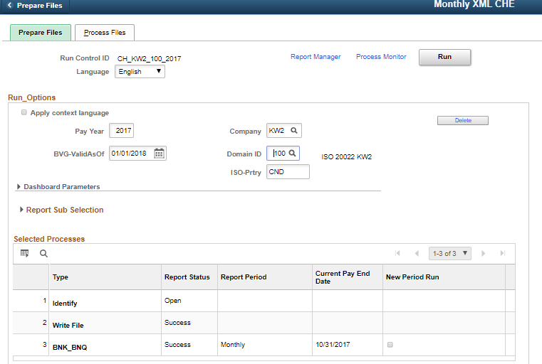

Use the Prepare Files CHE page (GPCH_EG_RSATUS) to prepare the ISO 20022 XML.
Navigation
Image: Prepare Files Page
This example illustrates the fields and controls on the Prepare Files page.
Field or Control |
Definition |
| Domain ID |
For Monthly Processing, this will prompt only for monthly domains. |
| Report Period |
For Monthly Processing, this is always monthly. |
| Current Pay End Date |
Defaults to the earliest open End date in the selected year. You can only save, if payment pre CHE ran for this period. |
| Run |
Starts Job GPCH_AE_XML which launches for monthly menu Job GPCH_MONTH. |
| ISO-Prty |
The values fills TAG TP/PRTY. If empty TAG doesn’t get created. |

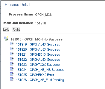

Image: Process Detail page
This example illustrates the fields and controls on the Process Detail page.

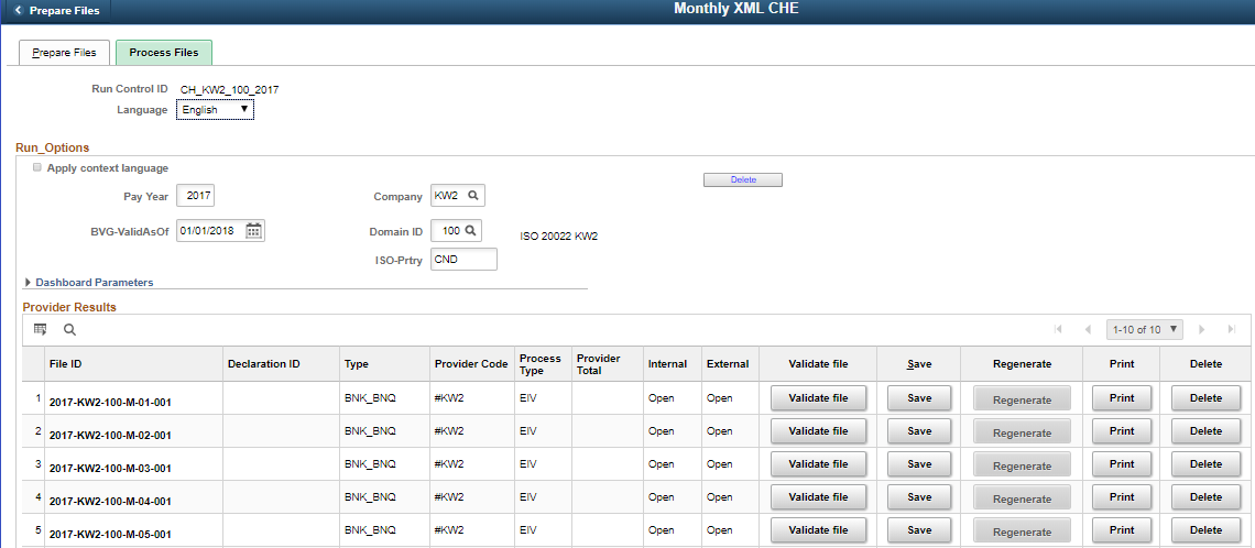

Use the Process Files CHE page (GPCH_EG_FSATUS) validate, review and save the ISO 20022 XML.
Navigation
Image: Process Files page
This example illustrates the fields and controls on the Process Files page.
Field or Control |
Definition |
| Validate |
Validates the XML vs. most recent ISO 20022 schema (currently pain.001.001.03.ch.02.xsd). |
| Save |
Saves the file to your target directory other than for all other domains save navigates directly to the robust file management page. |
Print contents of XML via BI Publisher. |
| Delete |
Delete the row for this month. |

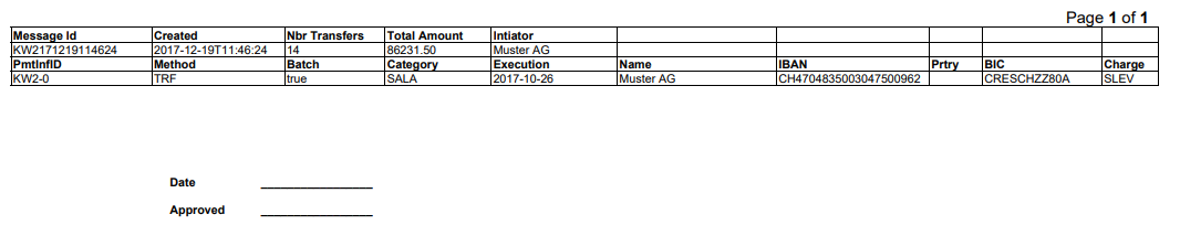

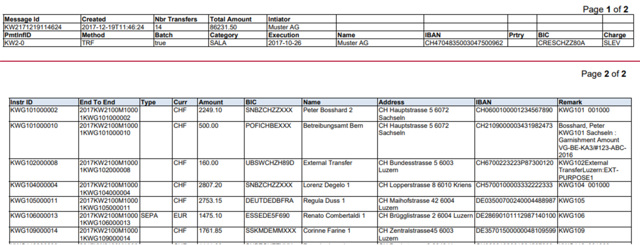

A BI PUBLISHER report (GPCH_ISO20022) is delivered to print payment information. The data source of this report is the ISO 20022 XML.

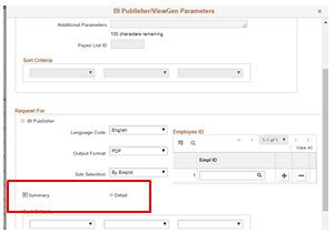

Image: BI Publisher ViewGen Parameters
Image: BI PUBLISHER report (GPCH_ISO20022)
This example illustrates the fields and controls on the BI PUBLISHER report (GPCH_ISO20022) for mode Summar ( = used for approval = 1 page) .
Image: BI PUBLISHER report (GPCH_ISO20022) for mode Detail
This example illustrates the fields and controls on the BI PUBLISHER report (GPCH_ISO20022) for mode Detail ( = used for detail review = 1 cover page + n detail pages) .
