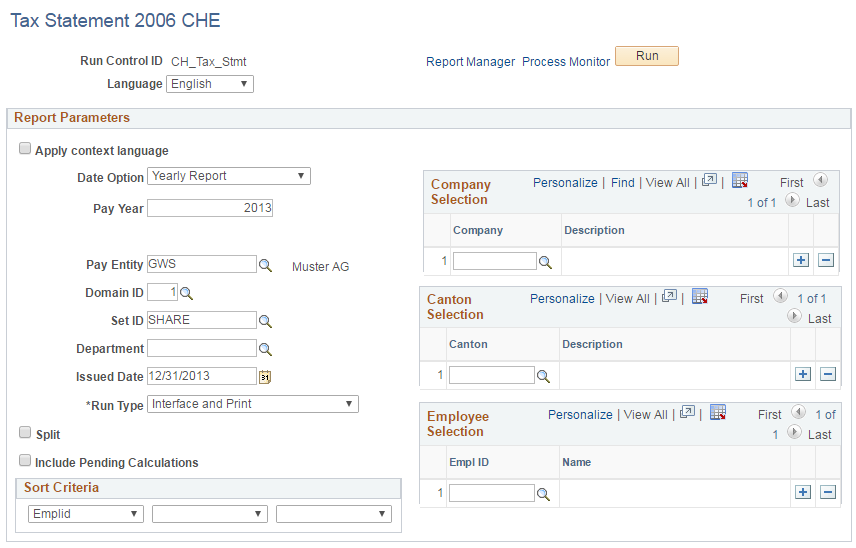

Use the Tax Statement CHE page (GPCH_RC_TX07) to create PDF files for tax statements (when the XML file was created through the dashboard).
Image: Tax Statement 2006 CHE page (Yearly Report Date Option)
Field or Control
Definition
Apply context language
Print in the employee’s language.
Date Option
The regular mode is Yearly Report. You can, however, choose Date Range. This option is not supported for Print Only mode, however.
If you select Yearly Report, the system displays the Pay Year field. If you select Date Range, the system displays the From Date ad To Date fields.
Pay Year
Enter the pay year.
From Date and To Date
Enter the date range for which you want to create a tax statement.
Pay Entity
Select the pay entity for which you want to create a tax statement.
Domain ID
Select the domain ID for which the XML was created.
SetID
Select a set ID if you only want to print statements for a certain department.
Department
Select a department if you only want to print statements for a certain department. In this case you need to also select a set ID.
Issued Date
If you want to override the creation date in the Form field I Ort Datum, enter a date in this field. To do this should have already selected overrides in Sender Details on the company level. If you don't want to override, leave this field blank.
Run Type
Select Print (recommended). The Interface run type is used for testing purposes and the creation of special tax statement scenarios.
Split
This option is not supported for the Print run type. Depending on the expat status, the tax statement can be split by expat status periods. This option is used primarily for testing purposes and the creation of special tax statement scenarios.
Include Pending Calculations
This option is not supported for the Print run type. In Interface mode selecting this option would include pending calculations, not finalized periods. This option is primarily available to support testing.
Sort Criteria
Select the fields that you want the system to use to sort the data.
Company, Canton, and Empl ID
Select the company, canton, and employee IDs for the statement that you want to print.
Selecting the Print run type creates a PDF file using the current official form. The system retrieves data from the XML as created through the dashboard. A barcode is enabled. In case the text in lines 2.3, 4, 7, 13.1.2, 13.2.3, 14 or 15 exceeds the size of the form, the system creates an additional page, which displays unlimited text. The second page is confirmed by the tax administration as well.
Note: Use this run control only for the Print run type. The creation of Interface files must be done through the dashboard before you use the Print run control. You can also create the PDF using the Swissdec tool called Viewgen and ignore this mass print. You can select subsets here. To print and view single employee IDs, use the online view and update feature.

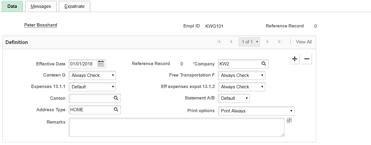

Field or Control
Definition
Canteen G
Override Check box G. Values are:
  • Always
  • Default
  • Follow Accumulator
  • Never
Free Transportation F
Override Check box F. Values are:
  • Always
  • Default
  • Never
Expenses 13.1.1
Override Check box 13.1.1. Values are:
  • Always
  • Default
  • Never
Expenses 13.1.2
Override Check box 13.1.2. Values are:
  • Always
  • Default
  • Never
Canton
Override canton of residence
Statement A/B
Override tax statement / Pension Statement (default ‘Tax’). Values are:
  • A
  • B
  • Default
Address type
Override source of address (default ‘HOME’)
Print Option
Override Check box G, Values are:
  • Always
  • Never
  • If not zero (default value)
Remarks
Track reason of override (not transferred to XML)

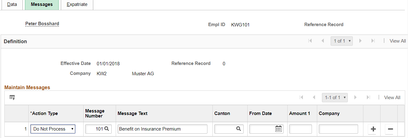

Field or Control
Definition
Action
Add, suppress or update generated messages. Values are:
  • Additional
  • Do not process
  • override
Message Nbr
Prompts for existing messages ( 1 to 9001)
Message Text
Defaults to setup text, overwritable as of setup
Canton
Fills canton in message (e.g.in message 1)
From Date
Fills from date in message (e.g. in message 1)
Amount 1
Fills amount in message (e.g. in message 7)
Company
Fills company in message (e.g. in message 5)

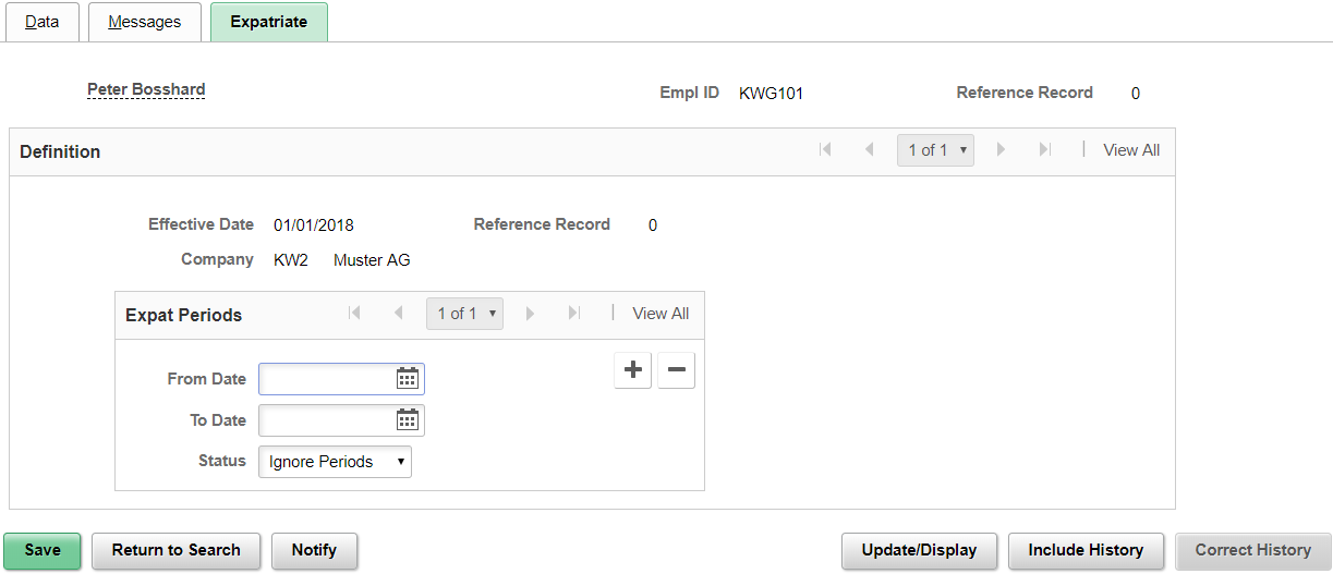

From date
Begin of Period to consider Status
To date
End of Period to consider Status
Status
Defines whether period is ignored or split. Values are:
  • Ignore
  • Split
