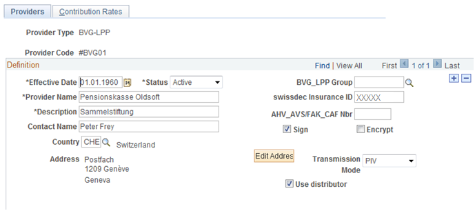

Use the Providers page (GPCH_SI_PROVDR) to set up insurance plans and insurance status for a provider.
Image: Providers page (1 of 2)
Image: Providers page (2 of 2)
Field or Control
Definition
Sign File
Mandatory for all Swissdec .
Encrypt File
Mandatory for Swissdec 4.0.
Transmission Mode
Select either EIV or PIV as the transmission mode.
Use Distributor
Select this check box for all Swissdec XML.
PK Insurance Status and Description
Enter a 1 digit number or character to represent the status of the PK insurance plan. Then enter a description in the Description field.
PK Insurance Plan and Description
Enter a 1 or 2 digit number or character to represent the status of the PK insurance plan. Then enter a description in the Description field.

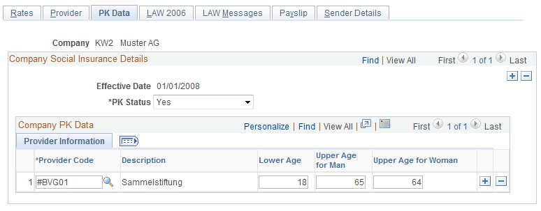

Use the PK Data page (GPCH_SI_COMPANY4) to select the PK calculation method for the company.
Set up age requirements.
Image: PK Data page - Provider Information tab
The Lower Age, Upper Age for Man, and Upper Age for Woman fields are required for both internal and external BVG calculations.

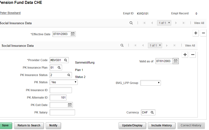

Use the Pension Fund Data CHE page (GPCH_PK_DATA) to select the PK calculation method for an employee.
Maintain employee pension fund data.
Image: Pension Fund Data CHE page
Field or Control
Definition
Valid as of
Serves as PK Entry Date, is filled by first Effdt and can be overridden if a different entry date applies.
PK Insurance ID
Enter an insurance ID or accept the default if you selected PK Insurance ID from EMPLID on the PK Data page.
PK Alternate ID
Enter a numeric ID to use when interfacing with PEKA. The system will populate this field with the Person ID if that field is numeric and less than ten digits.
PK Salary
Enter to override the yearly salary amount used to calculate the BVG contribution.

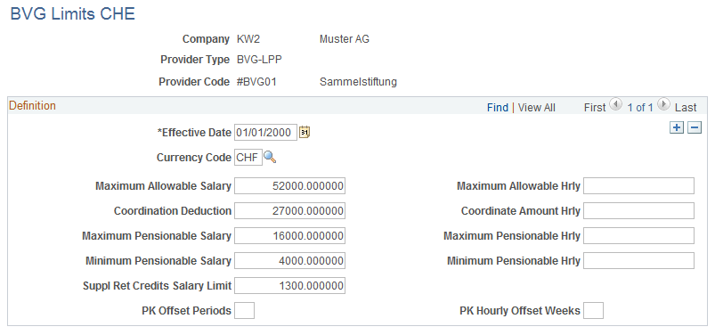

Use the BVG Limits CHE page (GPCH_PK_LIMIT) to define BVG limits.
Image: BVG Limits CHE page
BVG Limits CHE page
BVG Limits CHE page
Field or Control
Definition
PK Offset Periods
The number of months of employment required for salaried employees to enroll in PK.
PK Hourly Offset Weeks
The number of weeks of employment required for hourly employees to enroll in PK.
