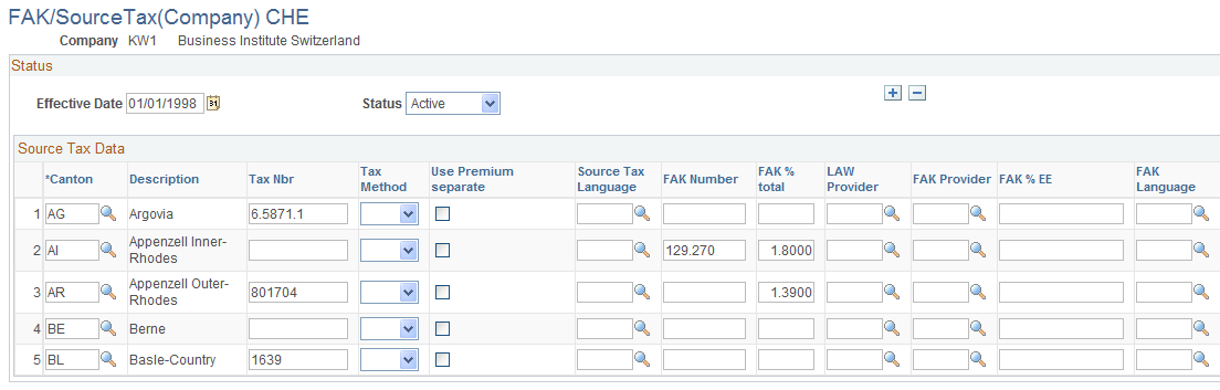

Use the FAK/Source Tax (Company) CHE page (GPCH_TX_FAK_STAX) to use this page to enter the FAK_CAF account assigned to your company by the FAK_CAF administration.
If the FAK Default Pct check box is not selected on the Rates page, then the contribution percentages come from this page.If the language on the run control page is blank, you need to select languages for specific cantons on this page, especially if you run one report that contains several cantons with different languages. Supported languages include English, French, German and Italian.
Image: FAK/Source Tax (Company) CHE page (1 of 2)
Image: FAK/Source Tax (Company) CHE page (2 of 2)
Field or Control
Definition
FAK Nbr
Enter the FAK_CAF account as assigned to your company by the FAK_CAF administration.
FAK% Total
If the FAK Default Pct is deselected on the Rates page, the system uses the contribution percentages entered here.
FAK Language
If you run one report for several canton with different languages, select the language for the canton. The system supports these languages: English, French, German and Italian.
FAK Provider
Assign FAK_CAF provider for cantons, where you want to create AK Banken and AK Versicherungen XML. This is the provider that gets mapped in Company Provider mapping.
FAK Month, FAK Quarter, and FAK Year
Not currently supported.

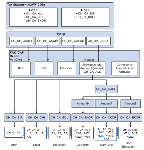

Here are the accumulators the system uses for the Tax Statement (LAW_CDS):
Line 1
Line 3
+ CH_CA_ALL
- CH_CA_BIR
- CH_CA_BKOR
+ CH_CA_BIR
+ CH_CA_BKOR
Here is a graphical representation of how information flows from the payslip to the FAK_CAF report:
Image: Graphical representation of how information flows from the payslip to the FAK_CAF report
Note: Since child allowance reporting is controlled by existing accumulators, we do not expect that you will have to make changes to child allowance accumulators.
