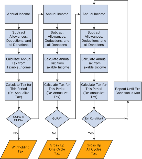

Tax Calculation Types Logic
The following diagram describes the tax calculation logic of the three tax calculation types:
Image: Tax calculation types logic
This diagram describes the tax calculation logic of the three tax calculation types.
For each calculation type, a repeating loop function is used in the tax calculation:
  • If the payee's current income uses the Withholding calculation type, the system completes the loop only once.
  • If the payee's current income uses the Gross Up One Cycle calculation type, then the system completes the loop twice.
  • If the payee's current income uses the Gross Up All Cycles calculation method, then the system continues to cycle through the loop until the difference between the tax amount of the current loop and the tax amount of the previous loop is less than 0.0001.
In each tax loop, the system performs the following steps:
  1. Calculates the annual total income based on the income for the current period and the year-to-date income.
  2. Subtracts each tax allowance and obtains the total taxable income.
  3. Looks up the tax rate for the total taxable income in the tax rate table.
  4. Calculates the annual tax amount.
  5. Calculates the tax for the current period.

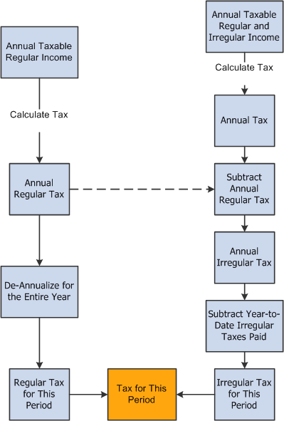

Calculation Logic In the Last Period of One Tax Year
The irregular tax calculation process in the last period of the tax year differs from the process during other periods of the year. For example, assume that the irregular tax calculation sequence is:
  1. Withholding.
  2. Gross up all cycles.
  3. Gross up one cycle.
The following diagram shows the process flow for calculating the withholding tax in the last period of the year:
Image: Irregular withholding tax calculation in the last period of the year
This diagram shows the process flow for calculating the withholding tax in the last period of the year.
