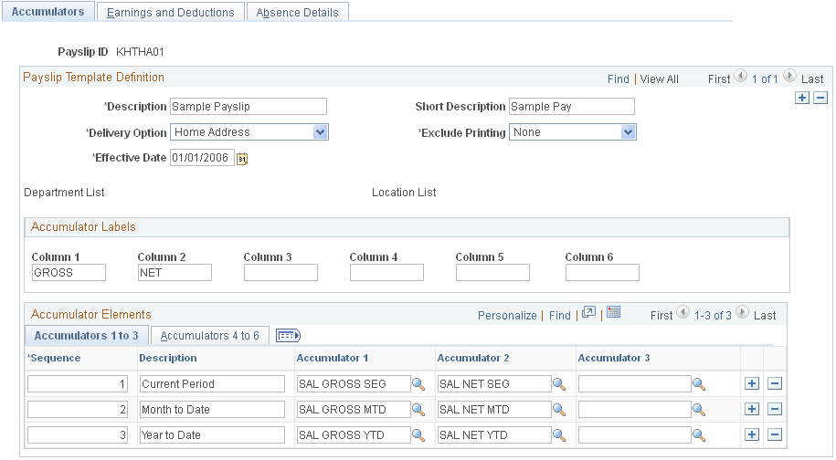

Use the Templates THA - Accumulators page (GPTH_PSLP) to set up delivery and print exclusion options, column headings (labels), and column contents (rows of accumulators).
Navigation
Image: Templates THA - Accumulators page
This example illustrates the fields and controls on the Templates THA - Accumulators page.
Note: Select the tabs in the Accumulator Elements scroll area to access additional views of this page. Fields that are common to all views are documented first.

Accumulator Labels
Enter the column heading labels for the accumulators that appear across the page on the printed payslip.
Accumulator 1 to 3 tab
Access the Accumulators 1 to 3 tab.
Field or Control |
Definition |
| Sequence |
Enter a sequence number to set the order in which the accumulators appear. They appear in ascending order. |
| Description |
Enter a description of each accumulator row. |
| Accumulator 1,Accumulator 2, and Accumulator 3 |
Select the accumulators to display for the corresponding column. Accumulator 1 values appear under the column 1 label, accumulator 2 values appear under the column 2 label, and so on. For example, you might have already have entered a description of sequence 1 and 2 as current and year to date. If you also want to display quarter-to-date accumulated amounts, you must create a new row, give the new row the description value of QTD, and select the accumulators that correspond to the column headings (labels). |
Accumulators 4 to 6 Tab
Access the Accumulators 4 to 6 tab.
Set up accumulators 4 to 6 on this tab. This is the same as the Accumulators 1 to 3 tab, except that it does not have sequence or description fields because the same sequence number and description apply to all six accumulators in the row.

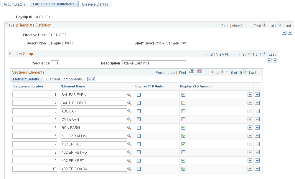

Use the Templates THA - Earnings and Deductions page (GPTH_PSLP1) to create sections of earnings and deductions, select from three description options, and set the element components (from the calculation rule) that the payslip displays.
Navigation
Image: Templates THA - Earnings and Deductions page
This example illustrates the fields and controls on the Templates THA - Earnings and Deductions page.

| Description |
You can create and name an unlimited number of sections. Create each section by entering a sequence number for it and a name, such as earnings. You can determine the sequence for the individual earnings and deductions elements that appear under these sections. |
Element Details Tab
Field or Control |
Definition |
| Display YTD Units (display year-to-date units) andDisplay YTD Amount (display year-to-date amount) |
Select these check boxes to have the year-to-date units and amounts for each element appear in the payment details region under the Year to Date Values heading. |
Element Components Tab
Field or Control |
Definition |
| Description Type andDescription |
You can create a custom description for each element. Select the following values for each element:
| Print Base,Print Percentage,Print Rate, andPrint Unit |
These check boxes represent the components of the calculation rule for the element. Select the components to show for each earnings or deduction on the component. You can select only the components that are in the calculation rule for the element. For example, for earnings with the calculation rule unit * rate, only the unit and rate check boxes are available for entry. If the component is not in the calculation, the check box is deselected and not available for selection. Note: The amount always appears, so it is not an option here. |
