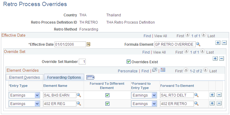

Retro Process Overrides Page |
GP_RTO_OVR_DEFN |
Specify the elements that are to be forwarded when the standard retro method is forwarding. Define overrides to the standard corrective retro method. Override the Retro Recalculation Option defined on the earnings and deduction definition pages. |

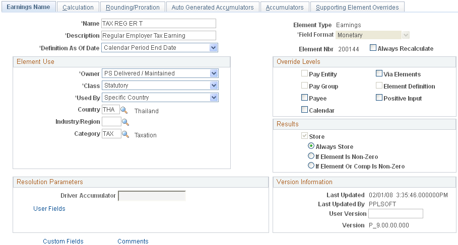

Use the Earnings Name page (GP_PIN) to name the element and define its basic parameters.
Navigation
Image: Earnings Name page
This example illustrates the fields and controls on the Earnings Name page.
Give your earnings element an appropriate name and description based on the naming conventions of your company.
Carefully define the override levels.
Do not select the Always Recalculate check box. Selecting this check box causes repeated recalculations of the earnings, making the calculated result inaccurate.
Give your earnings element an appropriate category.

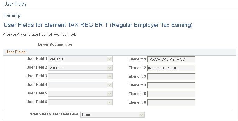

Use the Earnings - User Fields for Element <Element Name> page (GP_PIN_USR_FLD_SEC) to define user fields to create unique instances of an element.
Navigation
Select the User Fields link on the Earnings Name page.
Image: Earnings - User Fields for Element <Element Name> page
This example illustrates the fields and controls on the Earnings - User Fields for Element <Element Name> page.
For all taxable earnings elements, the User Field of Variable with the TAX VR CAL METHOD element must exist in the User Field group box.
Note: If the selected Element includes the Payroll Result record GP_RSLT_ERN_DED, then the User Fields are unavailable for entry.

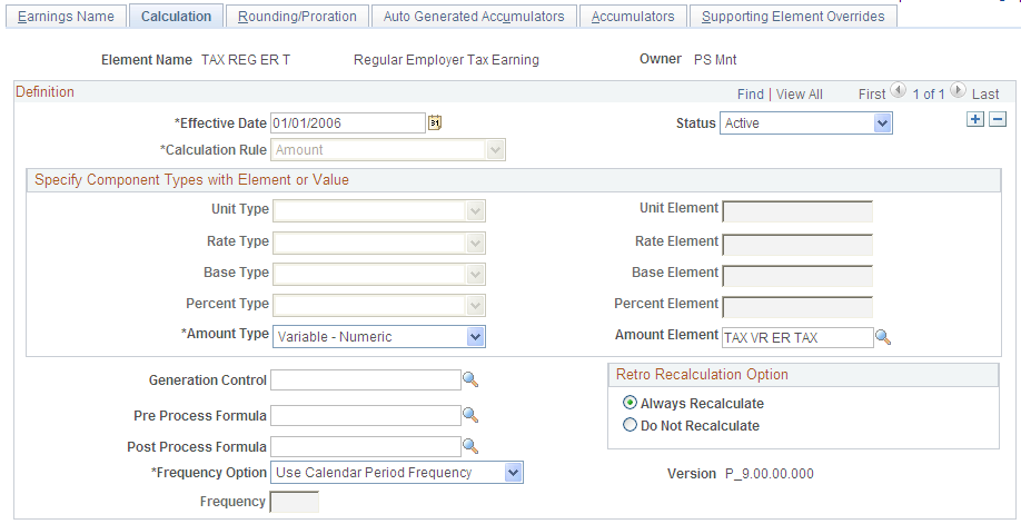

Use the Earnings - Calculation page (GP_ERN_DED_CALC) to define calculation rules for an earnings element.
Navigation
Image: Earnings - Calculation page
This example illustrates the fields and controls on the Earnings - Calculation page.
Choose a calculation rule, then define each calculation component. The values for the Calculation Rule field are:
Amount.
Base * Percent.
Unit * Rate.
Unit * Rate * Percent.

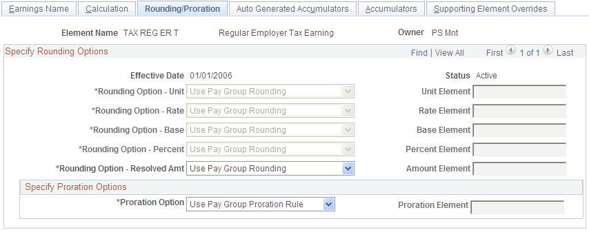

Use the Earnings - Rounding/Proration page (GP_ERN_DED_RND) to specify rounding and proration options for the components of an earnings element.
Navigation
Image: Earnings - Rounding/Proration page
This example illustrates the fields and controls on the Earnings - Rounding/Proration page.
Global Payroll for Thailand does not deliver rounding rules, use the core Global Payroll rounding rule to define rounding rules for your earnings element.

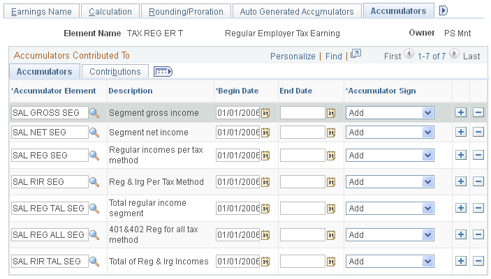

Use the Earnings - Accumulators page (GP_ERN_DED_AC_ADDL) to indicate the accumulators (already defined in the system) to which the earnings element contributes.
Navigation
Image: Earnings - Accumulators page
This example illustrates the fields and controls on the Earnings - Accumulators page.
Based on your requirements, consider adding your earnings element into the accumulators listed in the following table. PeopleSoft does not maintain these accumulators which is why they have an NM (not maintained) suffix . PeopleSoft delivers these accumulators only for you to add you newly created elements into. Use the NM accumulators only when you create new earnings elements. If you add existing elements directly into accumulators without the NM suffix (PS Delivered/Maintained accumulators), a conflict may occur between your modification and any new patches from PeopleSoft.

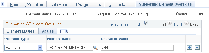

Image: Earnings - Supporting Elements Override page, Values tab
This example illustrates the fields and controls on the Earnings - Supporting Elements Override page, Values tab.

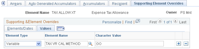

Global Payroll for Thailand uses the TAX VR CAL METHOD variable to determine the tax calculation method for individual taxable earnings elements. If your new element is used only under one tax calculation method, you can assign this tax method at the element definition level using the Supporting Element Overrides page.
The possible Character Values for the TAX VR CAL METHOD variable are:
WH: Global Payroll for Thailand uses the withholding tax calculation method for this earnings element.
GA: Global Payroll for Thailand uses the gross up all cycle tax calculation method for this earnings element.
GO: Global Payroll for Thailand uses the gross up one cycle tax calculation method for this earnings element.

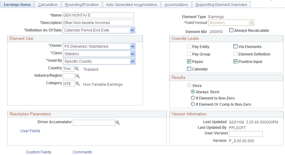

When you create non-taxable earnings elements, you can use the GEN NONTAX E element delivered by Global Payroll for Thailand as a template.
Use the Earnings Name page (GP_PIN) to select the GEN NONTAX E element delivered by Global Payroll for Thailand as a template
Navigation
This example illustrates the Earnings Name page with the GEN NONTAX E selected as the template to use.

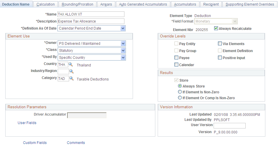

Use the Deduction Name page (GP_PIN) to name the element and define its basic parameters.
Navigation
Image: Deduction Name page
This example illustrates the fields and controls on the Deduction Name page.
Give your deduction element an appropriate name and description, based on the naming conventions of your company.
Do not select the Always Recalculate check box. Selecting this check box causes repeated recalculations of the deduction, making the calculated result inaccurate.
Give your deduction element an appropriate category.

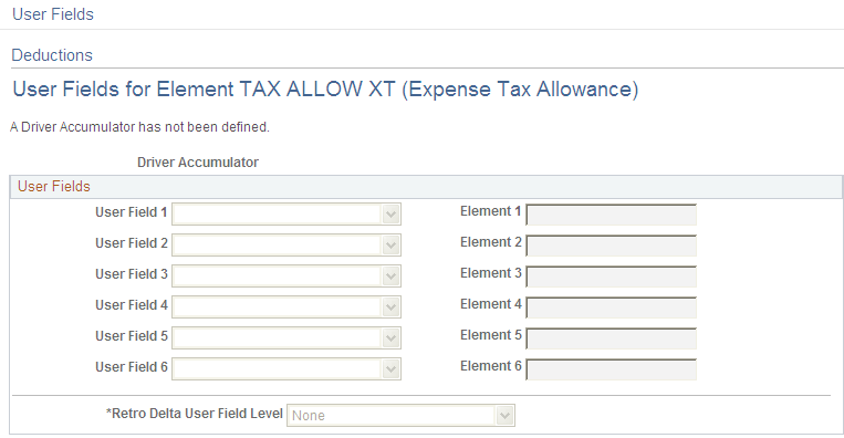

Use the Deductions - User Fields for Element <Element Name> page (GP_PIN_USR_FLD_SEC) to define user fields to create unique instances of an element.
Navigation
Select the User Fields link on the Deductions Name page.
Image: Deductions - User Fields for Element <Element Name> page
This example illustrates the fields and controls on the Deductions - User Fields for Element <Element Name> page.
You must enter the variable TAX VR CAL METHOD in the User Field for each taxable deduction element .

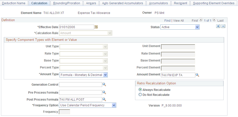

Use the Deductions - Calculation page (GP_ERN_DED_CALC) to define calculation rules for a deduction element.
Navigation
Image: Deductions - Calculation page
This example illustrates the fields and controls on the Deductions - Calculation page.

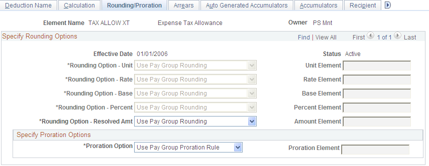

Use the Defining Rounding/Proration page (GP_ERN_DED_RND) to specify rounding and proration options for a deduction element
Navigation
Image: Deductions - Defining Rounding/Proration page
This example illustrates the fields and controls on the Deductions - Defining Rounding/Proration page.
Global Payroll for Thailand does not deliver any rounding rules, use the core Global Payroll rounding rule to define rounding rules for your deduction element.

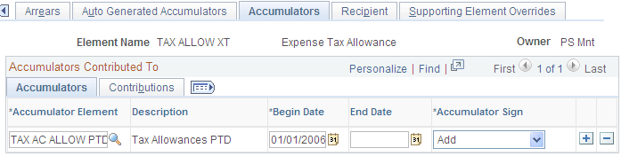

Use the Deductions - Accumulators page (GP_ERN_DED_AC_ADDL) to indicate the accumulators (already defined in the system) to which the deduction element contributes.
Navigation
Image: Deductions - Accumulators page
This example illustrates the fields and controls on the Deductions - Accumulators page.
Based on your requirements, consider adding your deduction element into the accumulators listed in the following table. Based on your requirements, consider adding your earnings element into the accumulators listed in the following table. PeopleSoft does not maintain these accumulators which is why they have an NM (not maintained) suffix . PeopleSoft delivers these accumulators only for you to add you newly created elements into. Use the NM accumulators only when you create new earnings elements. If you add existing elements directly into accumulators without the NM suffix (PS Delivered/Maintained accumulators), a conflict may occur between your modification and any new patches from PeopleSoft.

Use the Deductions - Supporting Element Overrides page (GP_ELM_DFN_SOVR) to override the value of certain supporting elements that are used by the definition of the deduction element or override the supporting elements when they are not part of the deduction definition
Navigation
Image: Deductions - Supporting Element Overrides page, Values tab
This example illustrates the fields and controls on the Deductions - Supporting Element Overrides page, Values tab.
Global Payroll for Thailand uses the TAX VR CAL METHOD variable to determine which type of taxable income the current taxable deduction element is subtracted from: withholding, gross up all cycle, or gross up one cycle. If your new element is used only under one tax calculation method, you can assign this tax method at the element definition level using the Supporting Element Overrides page.
Note: Since taxable deductions are subtracted from irregular taxable earnings using the same tax calculation method, whenever you add a taxable deduction to a given employee using positive input, you must make sure enough irregular taxable income exists to allow the deduction.
To create non-taxable deductions, use the same steps that you used to create taxable deductions, with the following exceptions:
Use the deduction name GEN NOTAX DD.
Do not add the TAX VR CAL METHOD variable to the User Field field on the Deductions - User Fields for Element <element name> page.
Do not add any non-taxable deductions into these taxable deduction accumulators:
SAL RIR NM.
SAL RIR TAL NM.
SAL REG NM.
SAL REG TAL NM.
SAL IR NM.
SAL IR TAL NM.
Image: Example of the Deduction Name page for the GEN NOTAX DD deduction
This example illustrates the fields and controls on the Deduction Name page for the GEN NOTAX DD deduction.

Set Up Retro Process Overrides
Select the elements to be forwarded on the Retro Process Overrides page
Image: Retro Process Overrides page
This example illustrates the fields and controls on the Retro Process Overrides page.
Global Payroll does not assume that every element in a process list should be forwarded, even when the retro method is forwarding.
