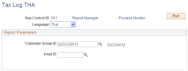

Use the Tax Log THA page (GPTH_RC_TAX_LOG) to generate the Tax Log report for Global Payroll for Thailand.
Image: Tax Log THA page
This example illustrates the fields and controls on the Tax Log THA page.
Tax Log THA page
After you run the Tax Log process, you can locate the report file using the following steps:
  1. On the Tax Log THA page, click the Process Monitor link.
  2. Locate the desired GPTHTX10 process in the Process List region on the Process List page and select theDetails link to open the Process Detail page.
  3. On the Process Detail page, select the View Log/Trace link to open the View Log/Trace page.
  4. On the View Log/Trace page, select the link to report file, in PDF format. The file name is a combination of the process name, GPTHTX10, and the process instance number.
You can also access the Tax Log Report through the Report Manager link on the Tax Log THA page.
For information about using Report Manager and using Process Monitor, see the product documentation information for PeopleTools: PeopleSoft Process Scheduler.

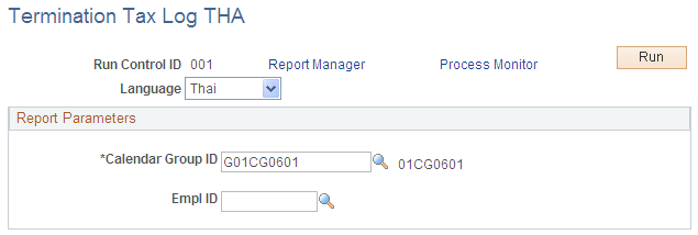

Use the Termination Tax Log THA page (GPTH_RC_TER_LOG) to generate the Termination Tax Log report for Global Payroll for Thailand.
Image: Termination Tax Log THA page
This example illustrates the fields and controls on the Termination Tax Log THA page.
After you run the Termination Tax Log process, you can locate the report file through the Report Manager link on the Termination Tax Log THA page.
For information about using Report Manager and Process Monitor, see the product documentation information for PeopleTools: PeopleSoft Process Scheduler.
