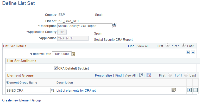

List Set KE_CRA_RPT
List sets enable you to create groups of elements and corresponding element attributes to associate with a specific application, such as a report. PeopleSoft delivers a sample list set for CRA reporting, associated to the Application definition CRA_RPT:
Image: List Set for CRA report
This example illustrates the fields and controls on the List Set for CRA report. You can find definitions for the fields and controls later on this page.

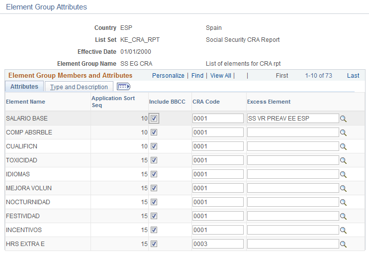

To indicate that the list set is the default one to be used for CRA reporting, the check box CRA Default List Set is selected. You can click the Element Group Details icon on the page to access the Element Group Attributes page. The configurations in this page indicate the behavior and specific code in CRA report for all standard elements belonging to element group SS EG CRA (according to Common Table T-84).
Image: Element Group Attributes for CRA Report
This example illustrates the fields and controls on the Element Group Attributes for CRA Report.
For each element you need to indicate:
Contribution behavior:
If the element contributes, select the Include BBCC check box.
If the element does not contribute, clear the Include BBCC check box.
CRA code provided by Social Security (Common Table T-84).
For concepts with exempt part from contributions and excess, you need to enter two rows:
One row for the excess, selecting the check box Include BBCC.
Second row with the concept, the excess and clear the Include BBCC check box. System reports the difference between the element and the excess, as excluded from contribution bases.

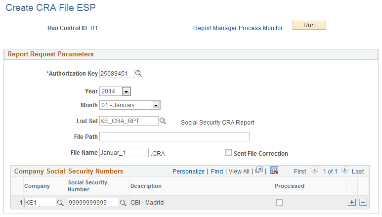

Use the Create CRA File ESP page (GPES_RC_SS_CRA) to generate the CRA file report.
Navigation
Image: Create CRA File ESP page
This example illustrates the fields and controls on the Create CRA File ESP page. You can find definitions for the fields and controls later on this page.
Field or Control |
Definition |
| Authorization Key |
Select the authorization key for sending the CRA file. You can create CRA file for multiples CCCs and companies, if all of them are managed through the same authorization key. |
| Year and Month |
Select the year and month for which you want to generate the CRA report. It includes data for the selected month and the retro deltas generated from the current month. The values available for selection are the year/months for which there are calculated payrolls. |
| List Set |
Select the list set that contains the information about the payroll elements to be reported. . Note: The sample list set we deliver is KE_CRA_RPT. |
| File Path |
Enter the directory in which you want to store the CRA file. |
| File Name |
Enter the file name to be sent to Social Security. The file name needs to comply with the legal requirements. The file naming requirements state that the file extension must be .CRA and the file name must have 8 characters. The system checks whether the file name follows the naming conventions, and show an error message if it is not named correctly. |
| Sent File Correction |
Select this check box if you want to re-send a file that was already communicated to Social Security. This ensures that the system compares the new data with the already reported data and prints the changed data. Note: When you re-generate
a file that was never sent to Social Security, do not select this
check box. Also, if you wan to replace the data on the record |
Company Social Security Numbers
Field or Control |
Definition |
| Company |
Select the company managed using the selected authorization key for which you want to select a CCC to be reported. |
| Social Security Number and Description |
Select the company Social Security Number (CCC) that you want to report. |
| Processed |
This check box is automatically selected once you have run a CRA report for the selected CCC and period. |
